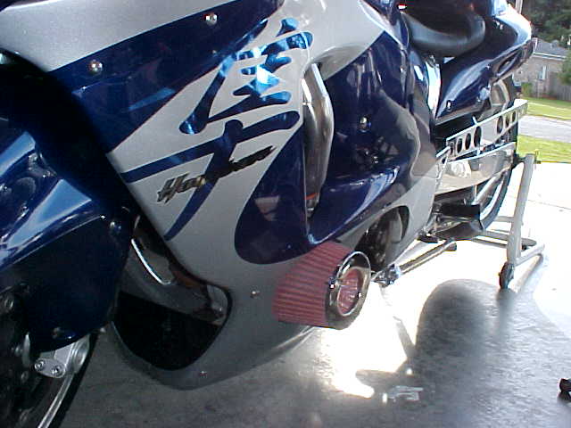

one more just for the heck of it...

LS6...Is that a Ghetto Kit???
LS6
Jun 3, 2004
19
Yes, this is a Ghetto with the fifth injector in the plenum.
