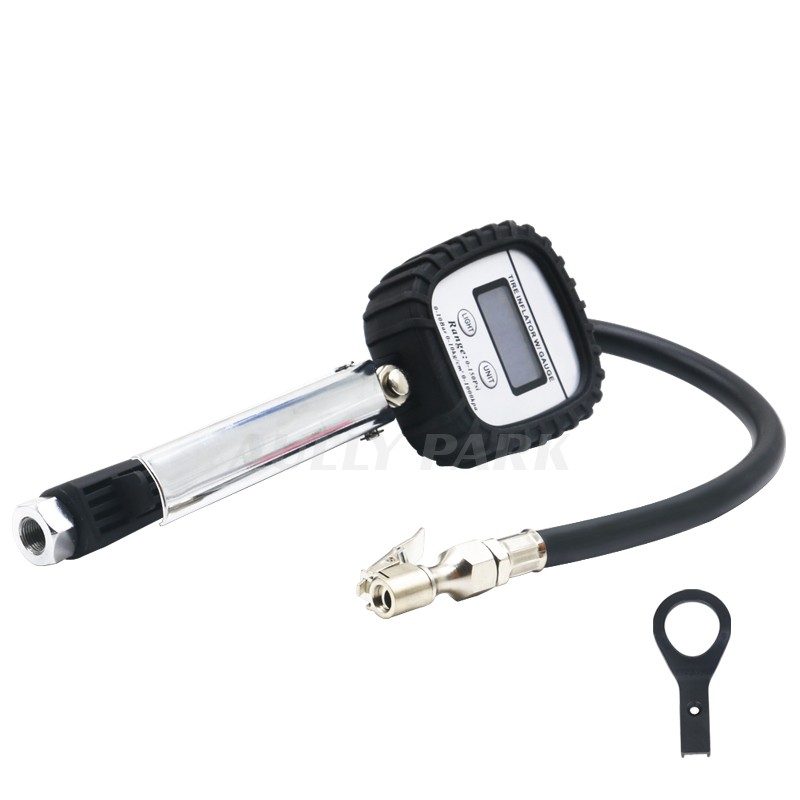

Back to the current source of my frustration. My kid bought me a Tcisa Digital Tire inflator off Amazon as a gift a few years ago. When I first got it I was actually pretty impressed. It seemed like a pretty well-made item, rubber armored and relatively accurate. The first sign of trouble is that the damn thing just wouldn’t shut off after use no matter how hard or long you press the power button. I resorted to taking the batteries out! Then when I go to use it after that, it is all over the place on pressure and has no apparent way to zero the damn thing. It is now just a fancy piece of junk. I have a couple of other analog Tire Inflators that work fine but I really want to get a good reliable Digital Inflator for the garage that my old eyes can read easily.
