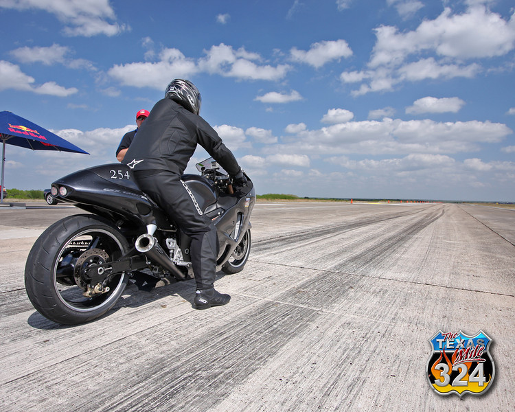

I did a 200 hp 1397 pump gas Busa stock gearing and wheelbase
First time ever at the Tx Mile and went 174 on his first pass then 176 on the next(he never got 6th)
stock gearing will easily get you 175 unless YOU are not areodynamic
