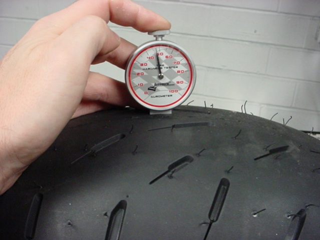

Below are pics of durometer comparison test, which is a tool that measures harness of a tire Lower the number the softer the compound is. Up till now the MCR2 has been the softest with no other tire able to touch it with a reading of 49.
Tires with compounds in this range get traction in almost any condition. Now on to sidewalls. A true drag radial needs to have a sidewall that will absorb power and then apply it to the track. Stiff sidewall tires do not do this efficiently as softer sidewall tires. Basically it goes like this...wrinkle wall slicks work so well with high hp bikes bikes because the sidewalls actually flex and allow the tire to still maintain traction while the sidewall takes the initial shock and apply's the power through to the tire and track surface. This allows more power to be applied! Stiff sidewall tires apply this directly to the tire and track surface which can cause spinning on a less than desirable surface and most importantly will not allow power to be applied early nor alot of of it.
The Shinko Drag radial is a soft compound tire with a 1 ply sidewall.(same as MCR2) It will allow optimum traction and power delivery. It is light weight! Lighter than its competition! Softer than its competition and more economical to use.

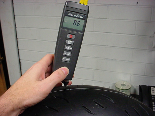

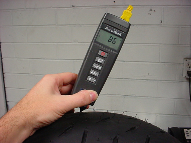

Below are softness comparisons between the Shinko Drag Radial and Michelin Power One and the Shinko Ultra Soft . All est were taking at 86 degrees and measured...to provide a accurate test. From what some have posted the MCR2 measure 48-52 on the durometer test.
1st and 2nd p pic is P1 tested 86 degress measured 54
3rd and 4th pic is Shinko Drag Radial tested 86 degrees measured 47
both tires tested have 6/32 tread depth....
Michelin Power 1
Shinko Drag Radial
