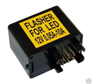

This is pretty much the same LED Flasher Relay I ordered from e-bay.
With this set up everything runs just fine. SBs work in front and rear. Running lights work. Turnsignals work. Switchback function works. Aftermarket LED flasher relay fufilled its intended purpose. So blink rate is normal. Perfect.

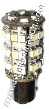

I ordered these 48SMT Switchback LED Tower from the same manufacturer off autolumination.com to replace the 2 front bulbs. They are 1157 Dual contact SB bulbs A-W.
These bulbs are the only ones im having a problem with. The running lights look great! The only issue I have is when I hit the turnsignal switch.

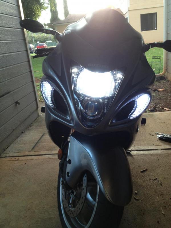

On the Left (of the picture) is the 20LED SB Tower. On the Right (of the picture) is the 48SMT SB LED Tower. Noticably brighter on the right. Which is what I wanted and why I ordered larger SBs for the front.
When I flick the turn signal switch the rear SBs and intigrated tail light operate fine. The front just kind of behave like they are trying to operate like they are supposed to but cant. They will switch between white and amber but not at the same rate as the rear lights or they will skip a cycle or two or they will just kind of flicker between colors when they are supposed to switch. Kinda like A-W-A-W-AA-W-AWAW-AAAAAAAAAAA-AWAW-A-W-A. There is no pattern, just a random series of switching, flickering and staying solid amber for 5-15sec before either flickering again or switching colors. When I press the switch at center the running lights come back on like they are supposed to. I want to say that it is either the bulbs or the flasher relay that I bought. Im going to put in the 48s and the factory flasher to see if they hyperflash. If they do then its not the bulbs its the aftermarket flasher relay. Im leaning more towards the new bulbs because I put back in the 20LED SBs up front and they work. :banghead::cursin::1zhelp:

It was the cheap crap bay led flasher relay. I bought a new one and plugged it in and all the bulbs flash at same rate now. *sigh* Glad that nightmare is over. Thank u all for the help with troubleshooting this pain in my arse.
