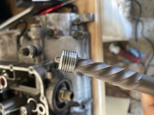

The Bolt behind the filter, the Allen head is rounded and I can’t remove it. Tried a ez out, and it broke. So now I have 1/2” of a ez out and the bolt to remove, any tricks before I start drilling?
I am going to try one more ez out on just the bolt head, but after that it’s drill time unless you guys got anything.
Thanks!
Also, this would totally suck if the motor was in the bike but I’ve already torn it down to just the cases

It has red lock tight on it,
Time for real heat, flame wrench

U remove the bolt when u remove the oil cooler
Damn red loctite

In case anyone was curious
