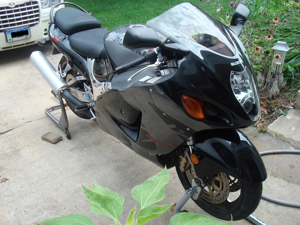

Some asked for pix.
What I started with.
Bike is originally from Germany and has been converted to make US legal.
Stickers EVERYWHERE! Cleaned, claybared, compounded, waxed, waxed.
Brakes were shot and binding up so I replaced them with a set of 2007 calipers from a 'Busa with 1500 miles.
Fresh fluids all around!
Replaced front seat because it was cracked and split. Windscreen was replaced for obvious reasons.
Flushed brakes and clutch.
Before
Now
