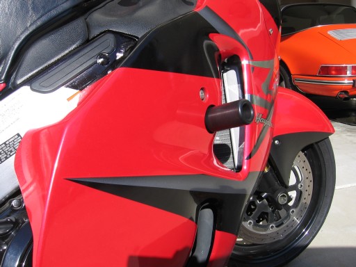

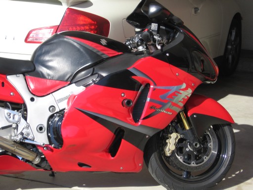

spot the paint! tried to match the lines of the fairing onto the frame much like VA...............Lamb is such a wanna be
"05 owners know about the sticker that doesn't cover the plastic completely.Talking about the sticker that goes betwen the two holes in the fairing where the blak runs at a 40 degree angle back! Cleane dit up here! Looks good huh???
