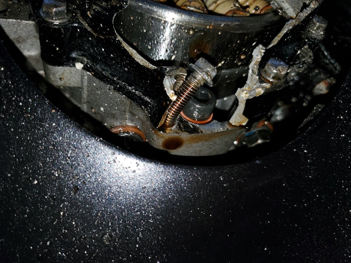

Slide pics from last night

Honestly. looks like you might want to total it though bro. If you just want to do a build be sure the engine is ok first. You can probably run it (check noises and leaks) once the stator issue is resolved. In any event you want someone who knows what they are doing give it a close look.
That bent bolt in the lower engine case by the stator may have broken the engine case . A cracked engine case will total the bike most of the time . If you need a black front fender let me know . yours for shipping cost .
Yeah that's what I'm worried about but my hands are to sore today to get down underneath her to get a good view. I'm going to try to get her up on the rear stand when I get home so I can see better
Well the motor case is ok just the stator cover broke.

I thought the stator area did not have oil in it? Where is that oil coming from?
Uhmm...?! Then I may have a bigger problem than it looks like cause there was oil coming from there right after we went down unless theres something hurt under the fairings I havent seen yet
