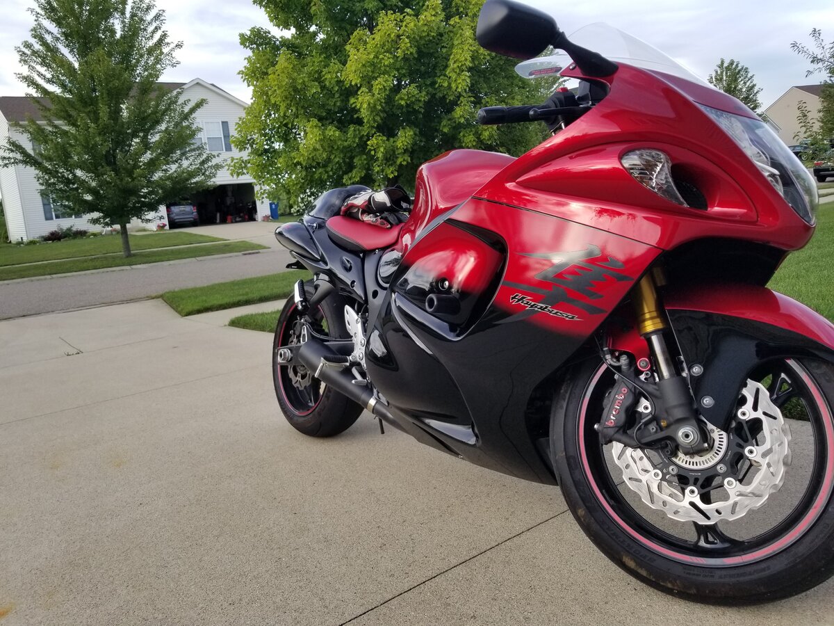

OK guys shes finally back home!!!!
Now I am working on sealing in the piston rings for the next 500 miles ( already put about 200+ on it) and then she should be all done. As you can see in the picture, I also got the charge pipe changed to black
What an experience.
Another lesson learned : No dig racing with the 3D chain as the bike has to much HP and will just stretch the chain out. Another $300 lesson learned.
What an experience.
Looks great, you wouldn't even know it was a monster....the stealth look is best IMO.
