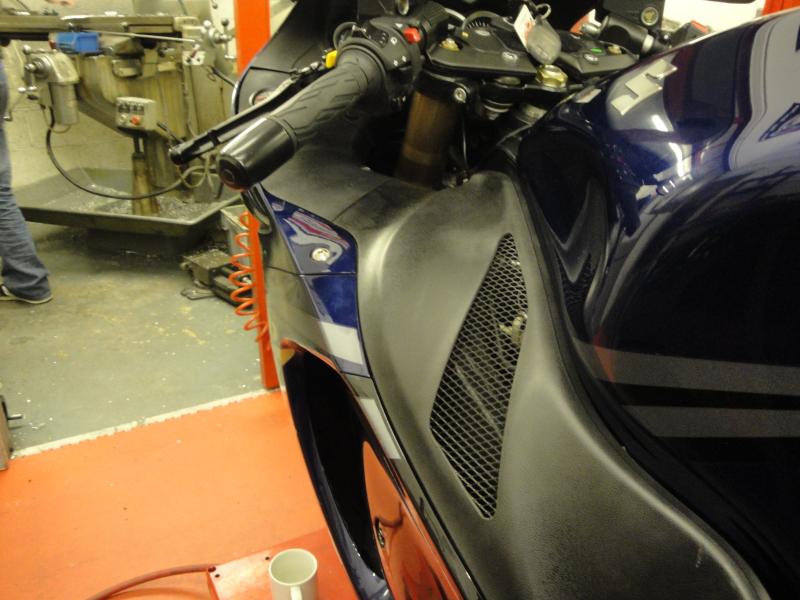

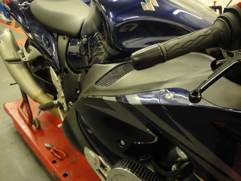

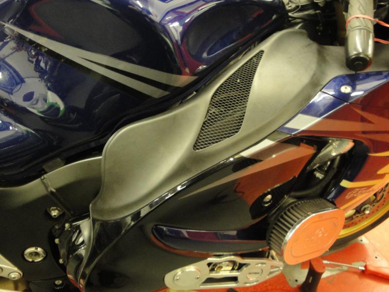

here's the installed under tank ic. the left airduct forces air through the ic then we have raised the tank 19mm and put exit ducts in the fairing infills to help the hot air escape. Nice this time of year :)
