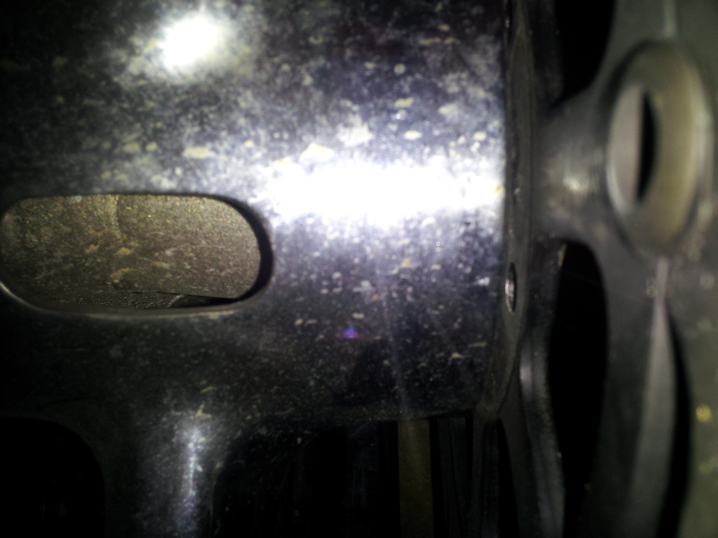

Need help with a rotor install. i got a new/used rotor to replace a missing rotor on the busa. Its the same rotor as far as size goes but it doesn't easily fit over the hub. What can I do besides bang it into place?
I got it on properly but it just seems like it is a little to small to fit around the hub.
Any help would be appreciated

Front? Chrome/powder coated rim? gonna need to clean the extra finish off were the rotor sits in the hub.

Chrome = all your tolerances are all different.
It's a tight fit.

you will need to file the rotor untill it fits

Dremel tool fixed it up. Shaved the inside of the rotor and it fits like a glove. Just wanted to be sure before I shaved off material because once its gone, thats it.
Thanks for all your help guys.

Be sure of the proper torque and don't forget the locktite.

Not a probem to shave it, the rotor bolt aling it
