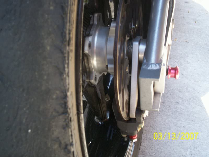

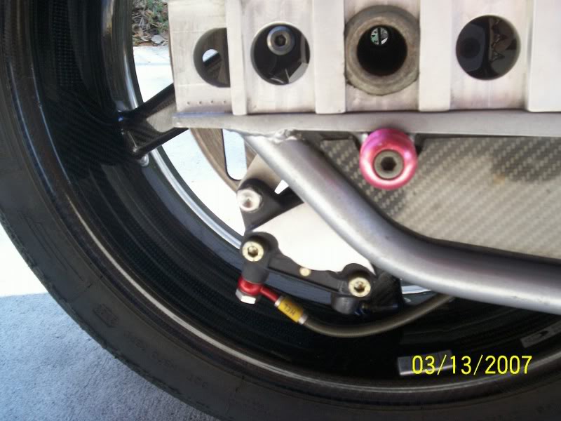

Here is a pic of my Brembo rear caliper,the caliper hanger that I made and the stock rear rotor that I modded

Hmmmm....you had to manufacture your own rear bracket
?.......what's that all about ?. Other than that..........LOOKS SWEET !!!!!!
Build me a bracket, and I'm in there.
BTW are those Dymag rear wheels you're running or are my eyes deceiving me

(Spudley @ Apr. 11 2007,05:16) Hmmmm....you had to manufacture your own rear bracket
He made the bracket so he could run a Brembo caliper...and those wheels are BST's
I had the make my own braket to clear the swingarm. Those are BST Wheels.
