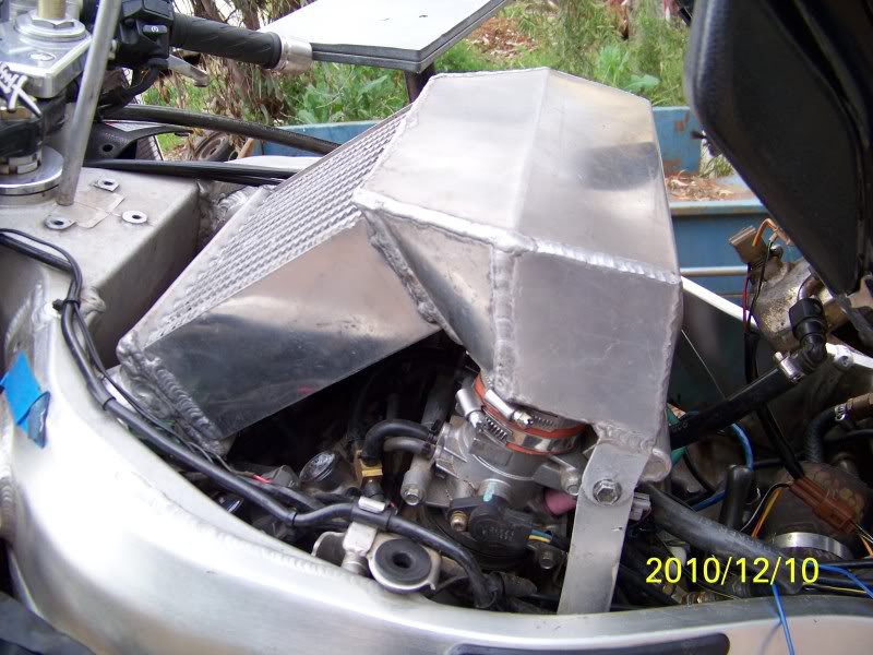

I would love to have an intercooler like this one in my bike! I am building a streetable 6psi set up, but want an intercooler to make it as safe as possible. I take my bike on cross country trips and would like to have the peace of mind to open her up on long streatches. Does anybody know where I could get an under the gas tank intercooler built? Or does anybody have one they would like to sell?? I know that rcc offers one for $2300 which is a bit too much for me to spend.
That one pictured will not work well
putting the air into one end of the plenum realy upsets the cyl filling
Work much better like this
For 6 psi you don't realy need an intercooler, your not creating enough heat to make it worthwhile
beyond 10 yes your going to see some gains
Yep not as good as a front mount , or water/air
but with the ram air and above radiator air ducted and the intercooler sealed to the tank, they work ok
I had great use of the one pictured running 12 psi for several yrs before converting to water/air
That first one is like heating the rooms down a hallway.. the first room will always be the warmest and so on till the end of the hallway. The builder of that one must not have ever lived in a place bigger than 1 room.. :rofl:

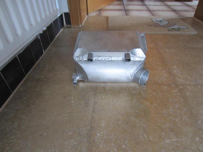

Below the tank the only efficient solution is air-liquid.
That was in 2011, the biggest core which i can get from bell, the rest
of the parts from MCX and a welder who have to get some more
training in aluminium...hehehe
My opinion ist still, that the water have to flow vertical,
not horizontal, that there is the same temperatur over the whole
width. About this i make two waterciruits and each in seven sections.
280 $ at bell, 3000 SEK at MCX for single parts, so round about €600 for
parts and 7 hours time on the lathe, milling machine, cutting and banding plates
and get the stuff to the welder.
Once sealed to the tank and sides it can only go through the fins , even the up pipe ram air gets something passes the up pipe , and there is good flow above the radiator if a shroud is made to direct that air too
like i said i ran it for several yrs and kept improving the setup
Max has a nice Water/air unit, i made my first water/air with vertical water movement , but changed to side tanks on later , just need a good water flow and there is very little temp gradient acoss the core
