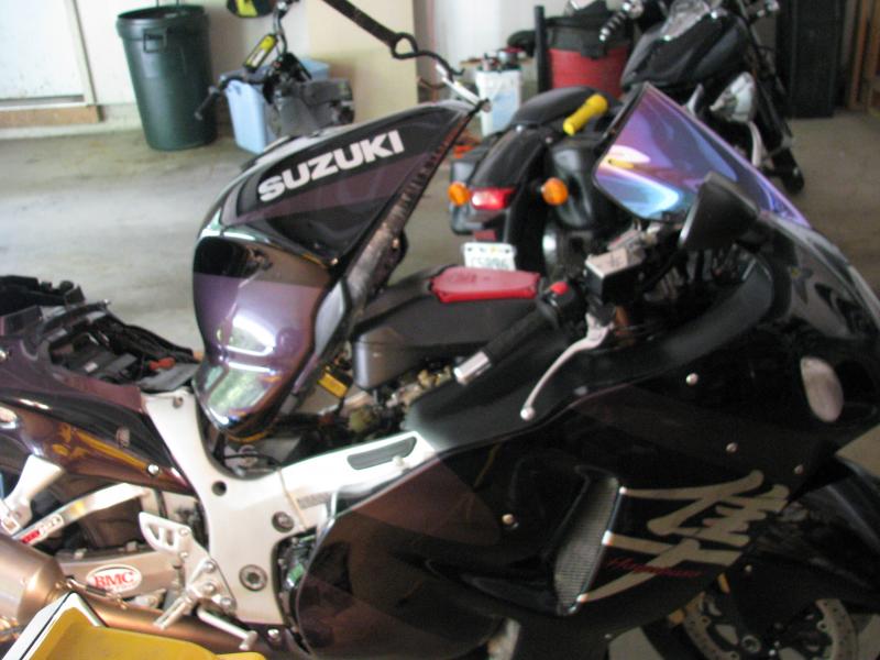

Step Two: There are two bolts at the front of the gastank holding in it place(#4 allen) Remove those and this will allow you to lift up the gas tank. I have hooks in the ceiling and use a Tie-down to keep the tank up.
shown here

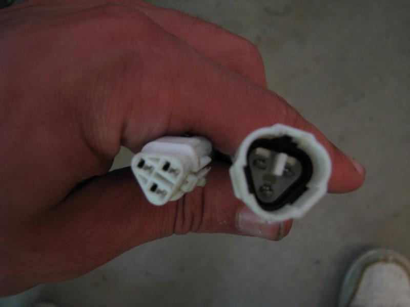

Step 3: Under the tank on the left side of the frame you will see a bunch of wires and connectors. In the mess you will find one that is white and Triangle-3pronged shaped, pictured here

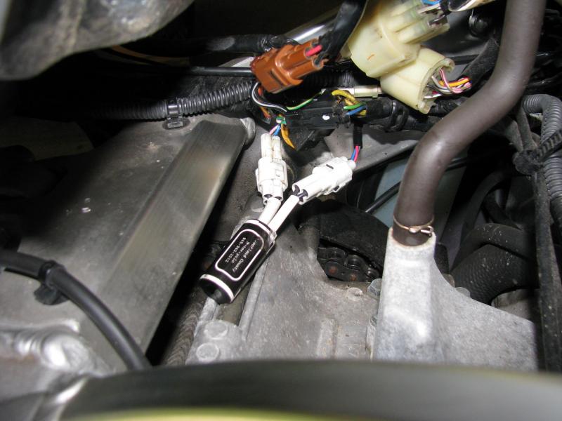

STEP 4: simply disconnect this cable and inbetween the two connectors use the male and female sides of the TRE to complete the circuit.
Picture of the TRE connectors HERE
mine works great. I had it switched off by accident the one day and thought i had a vac leak or something.
downside is that you run 5th gear fueling tables in all gears, which for max performance is the wrong direction to go.
