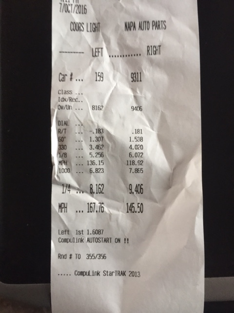

update Doug Witt pro st rider rode my bike at MDIR race last weekend, and he is 180lbs, no set up change in bike so clutch and shock were set up for me not him, and with a shitty 60 ft due to wheelie 1.30 in 60 ft UGH bike still went 8.16 at 167mph ON ALL MOTOR Doug said that if we set shock and clutch for him the 60 fts should be 1.20 etc. if that is case that is a possible 7.80
this can be a great grudge or bracket bike as its not all cut up, also Bob Carpenter will tell you, lower compression and street ride this baby, he has several doing it now and they still make 250 plus RWHP and TQ you cant believe I will post time slip of Doug's Run Brett View attachment 542121
