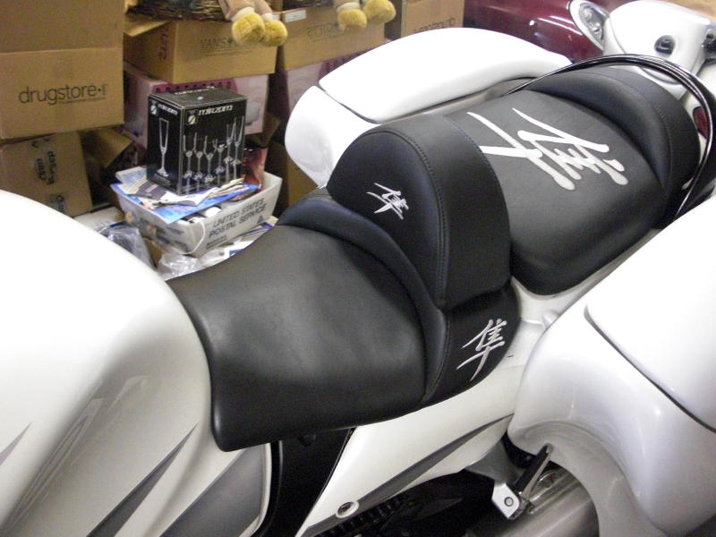

This is a bit odd - as I could have just fitted a replacement battery, but see the attached pictures: I squeezed the GenII battery (YTX12-BS) in the GenI bay (YT12A-BS [OEM/Japan: FT12A-BS]). To make it fit properly, I should have dremeled out some of the seat-underside plastic, but it's less than 1/4" after you remove the 'bumper' - there seems to be enough give.

Some pics below: notice that the GenII battery after adding of the electrolytes (prior to charging) already shows a higher voltage (12.55V) than my GenI battery does after a short ride (12.36V).
