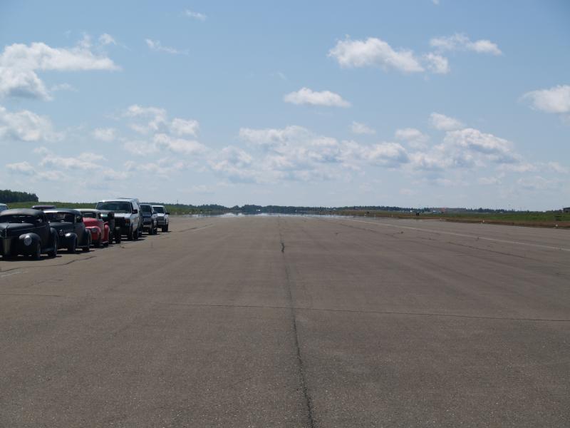

1st pic... from the start line
2nd pic... from the finish line
it's so far away all you can see is the mirage off the pavement.![]()
