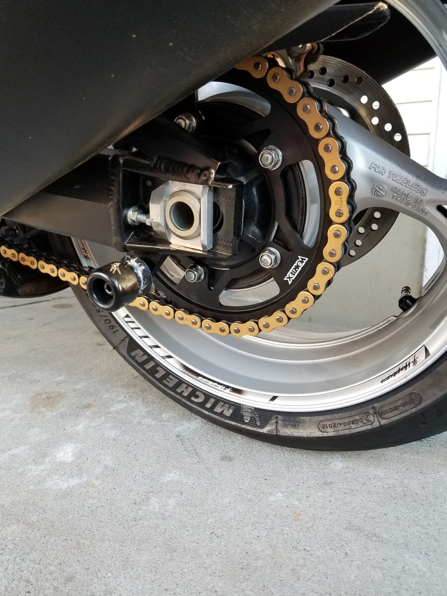

The two pictures show difference in where the new wheel position with +3 , looks like about 1 inch shorter wheel base

@Busaindena
your pic seems to show a chain without any slack but straight like "laying on a ruler"
man - that way, without any slack, you at 1st will kill your chain (or did it already, feelable & visible by some 2 or 3 inflexible / "stiff" links if the chain get its 1" slack)
and at 2nd the bearing at the sprocket shaft directly behind the sprocket in the crankase.
to 1. easy to fix with a new +1 link longer chain or by a -1 tooth / 17 teeth (instead of the at the gen2 usual 18) front sprocket - i guess
to 2. damn hard job , the engine must be pulled and the crankase needs to be splitted
in general - when the swing arm goes up because the shock absorber compresses,
the chain "shortens", so to speak, due to the geometry of the swing arm to its pivot point / to the distance to the pivot point / shaft (pinion)
what then causes the destructive giant force on the front bearing, which then leads to the destruction of the bearing in the last step
and if then only a single ball of the bearing (or fragments of it) go inside because the bearing cage breaks ==> "tooth loss" on the gear wheels up to broken / bent shafts, everything is possible
and then "good night" transmission :( means in worst case a total loss of the trans.
my own exp. : that wandering ball , around 25 years ago, i have had at my ´80 z1000
followed by a total loss of both shafts and all gears - but not caused by a missing chain slack but by a not correctly tightened sprocket nut. the result - a huuuuuge and incredibly high bill.
so ! - what ever you do do it quick - at very 1st control a.s.a.p. - in a max silence around you - if there are any bearing noises when turning the wheel in neutral and motor off
and then, if no noises hearable, give the chain a.s.a.p. a visible slack of 1 inch minimum
measured in the middle between rear axle and pivot point of the swingarm.

I still have some adjustment left with +3 , I move the chain to its tightest spot and and measured 1 inch movement .
I had my eye out for the rubber band stretched chain too. It's a little hard to say from the pic with the stock muffler on there but from what I see, the tension looks OK. The book says 0.8"~1.2" slack. If you ask me, that is a bit on the tight side. I go for an inch and a quarter or maybe even a little more. It might be hard to measure it on one run without the swing arm getting in the way. Here's how I do it:
Leave the bike on the side stand. Lift the chain and measure the distance the top run travels with a 14" ruler held against the side of the chain, there is a nice spot on the undertail to butt the end of the ruler against. Relax chain (don't pull it down, just let it relax), now pull and measure the bottom run. Now add the two measurements. Use only about 2 lb of force when you pull the chain for both measurements.
After the chain is adjusted and the bike is on its side stand, the chain should mostly be resting on the swing arm chain guide. The bottom run should droop a little. If the chain lays on the chain guide all the way to the end, that is too loose. That is when I know I need to adjust mine. If you can see most of the chain guide, that's too tight once you put your weight on the suspension and ride.
A new chain needs to be adjusted frequently. If your chain is laying on the chain guide after a couple hundred miles, that's probably normal at this point, it doesn't necessarily mean it was overtightened. Just be careful that it's laying on the chain guide most of the way and I think that will be good for a visual. The measuring takes some judgement but the visual is a good backup.
