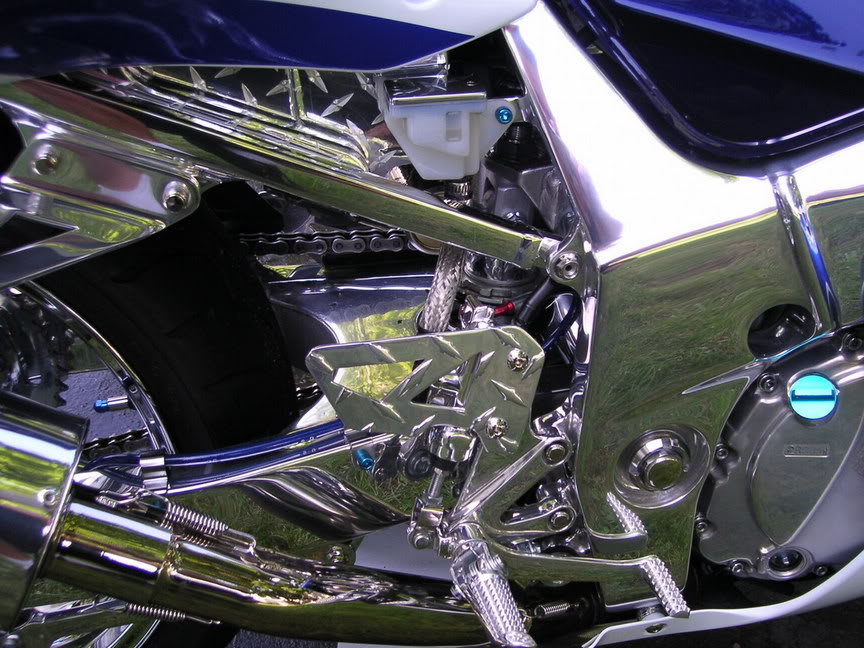

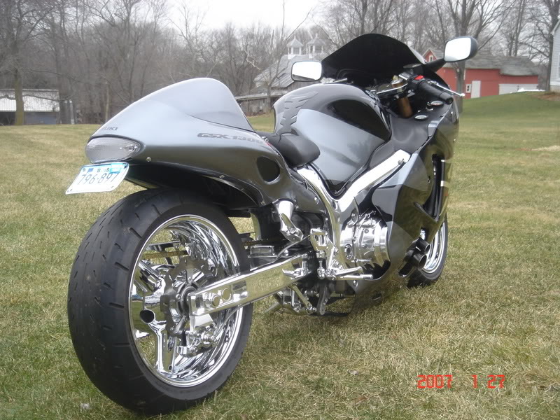

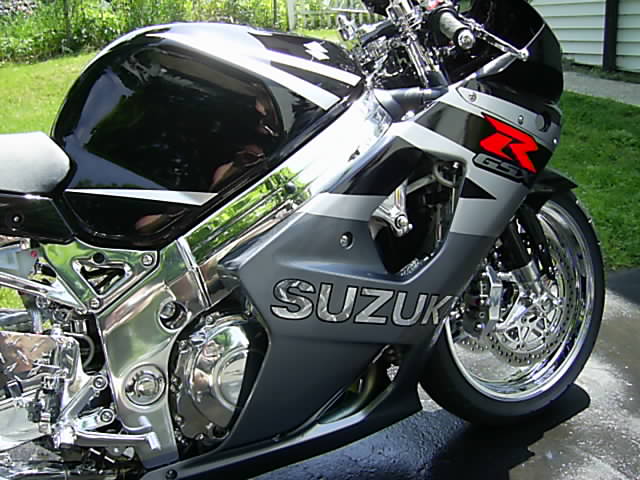

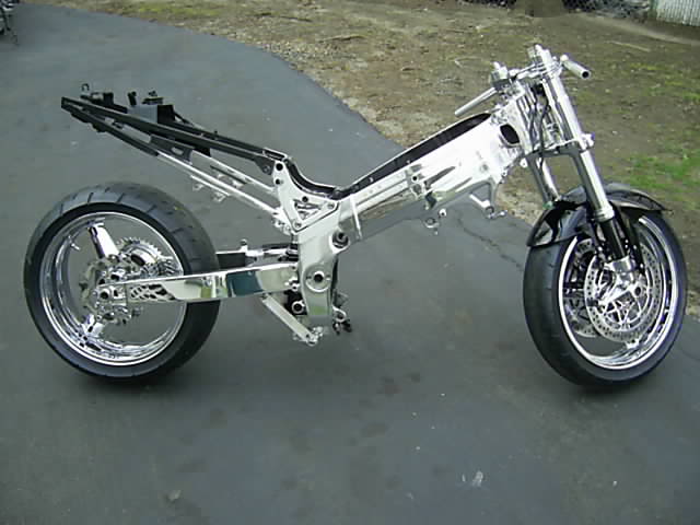

I do polishing and Im also making a how-to-polish video for just this reason..
Im in Connecticut and not far from Mass..anyone what their bike done let Me know!!
I can do small parts threw the mail or full custom jobs!!..Been doing it for over 20 years!!!
(203)768-2710
Hers a few pics of My work for those Who havent seen it>>
