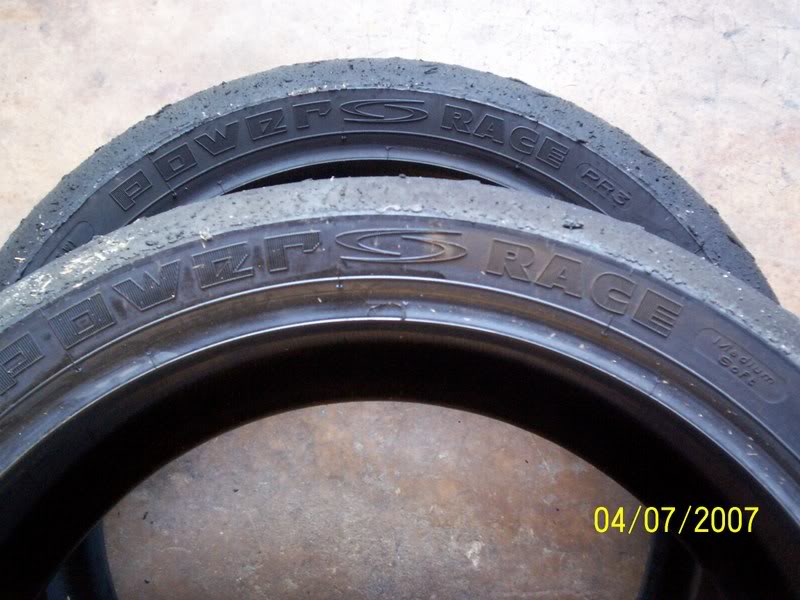

Have any of you ran the Michelin Power Race DOT tires on the Road. I did not know how they would do warming up on the street versus on the track.
VMAN1300 lives near the gap so he runs them. I don't advise it. I use them on the track & only w/ tire warmers. You can't keep enough heat in them on the street.
I'd say don't do it. Get you some PP 2C2s, BT-016s, Dunlop Qualifiers, Pirelli Corsa 3s, Metzler M3s, any of these will work much better on the street.
Maybe at the Gap, with warmers, on a no cops, no traffic, bike on your knee every corner day.. but otherwise, your way better off with any of the above.
Yes I have, they are incredible tires...FOR TRACK USE. They must be heated to operating temp for them to come alive....95% of street use will not sustain that temp range. Terribly fast wear, no sidewall tread and operating temp range are critical issues for this tire on the street. There are too many great hi po street tires available for street use to consider using track tires like these. Do a search and there is much text on the org explaining tires and tire choices. Good to ask this question BTW! Raydog

As most of you know, I'm no michelin fan. However, if you are making a choice between a DOT track tire and a High Performance Street Tire, I'll share my view.
At no time does a street tire perform better than a track tire. This rule doesn't apply in the wet. All track tires perform poorly in the wet. Keep that in mind if you get caught in a rain shower on Race rubber. A race tire will warm up at basicly the same rate as a street tire, it just needs more heat than a street tire to perform at it's best.
Today's hypersport tires have closed the gap to a very narrow margin between street and track rubber. Generally speaking, your street tire will perform best at around 135 degrees and your race tire has to reach 170 degrees to perform at it's best. The difference in these two tires is extremely small at 135 degrees. And,,,,,,,,,,,, you will NEVER get a race tire up to 170 degrees on public roads. It's extremely hard to get a street tire to overheat on the dragon unless it's a blistering hot day and your air pressure is 5 lbs to low.
My view in short is, you don't get better performance from a Race tire unless it reaches temps much higher than you can reach on public roads and you'll loose performance in the wet. While a street tire won't perform better than your race tire, the street tire will have a longer life.
The choice is yours and you can't go wrong with either tire. I run race takeoffs most of the time during the warm summer months only because I have piles of them. I tend to avoid them during the wet winter months. I have learned from experience, braking on wet pavement on race tires can be very tricky business.
