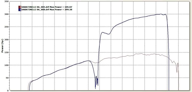

Congrates to Mr Dean Sabatinelli for smashing 2 records at Maxton 1 mile run this past weekend. Dean went 203 naked (No fairings)on a 188 record, and 218 faired on a 209 record.
Dean had a problem in the past using Nitrous. He melted a piston while he was fogging the airbox. Dean contacted me about my spraybar, he had questions about the duration of spray and the chances of the nozzles clogging. Of course I explained to him it was not a problem since I had already tested my Spraybar for LSR runs and clogging was not a problem.
Dean and I went back and forth via email on the setup. His Nitrous system is extremely effecient. A 62 jet at 750 psi = 150hp. Here is the Dyno chart.
