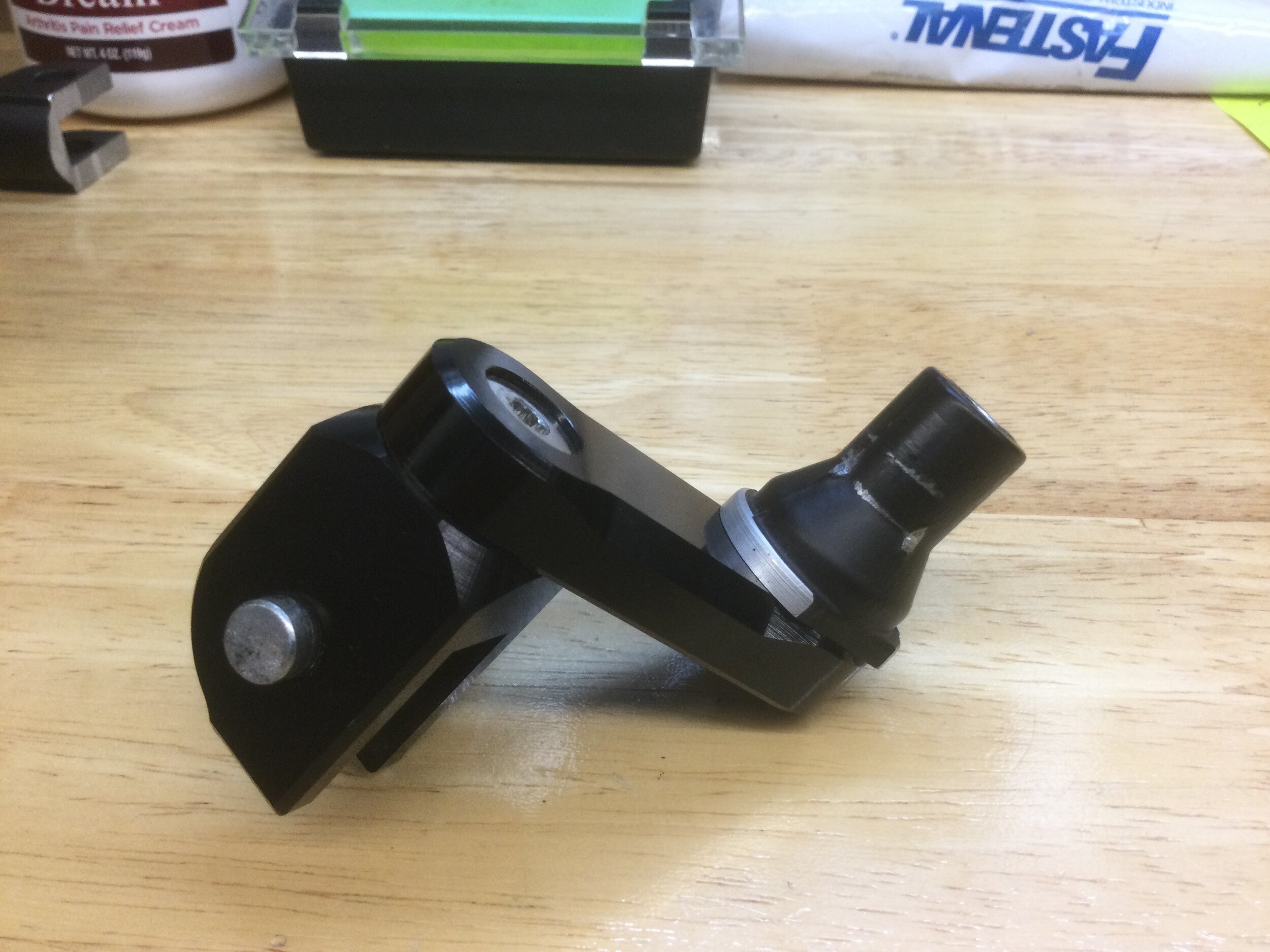

Do you know any welders? They could tack the barrel to the arm so they don’t spin.
I just re read the original post. Are you talking about the silver ones or the black ones
The black ones , someone mentioned the pegs spinning from weight with just the bolt going through. So I figured I would mention it here to see if 60 + busa had any issues with that happening.
60+ Busa Rider
Mar 11, 2022
902
1,689

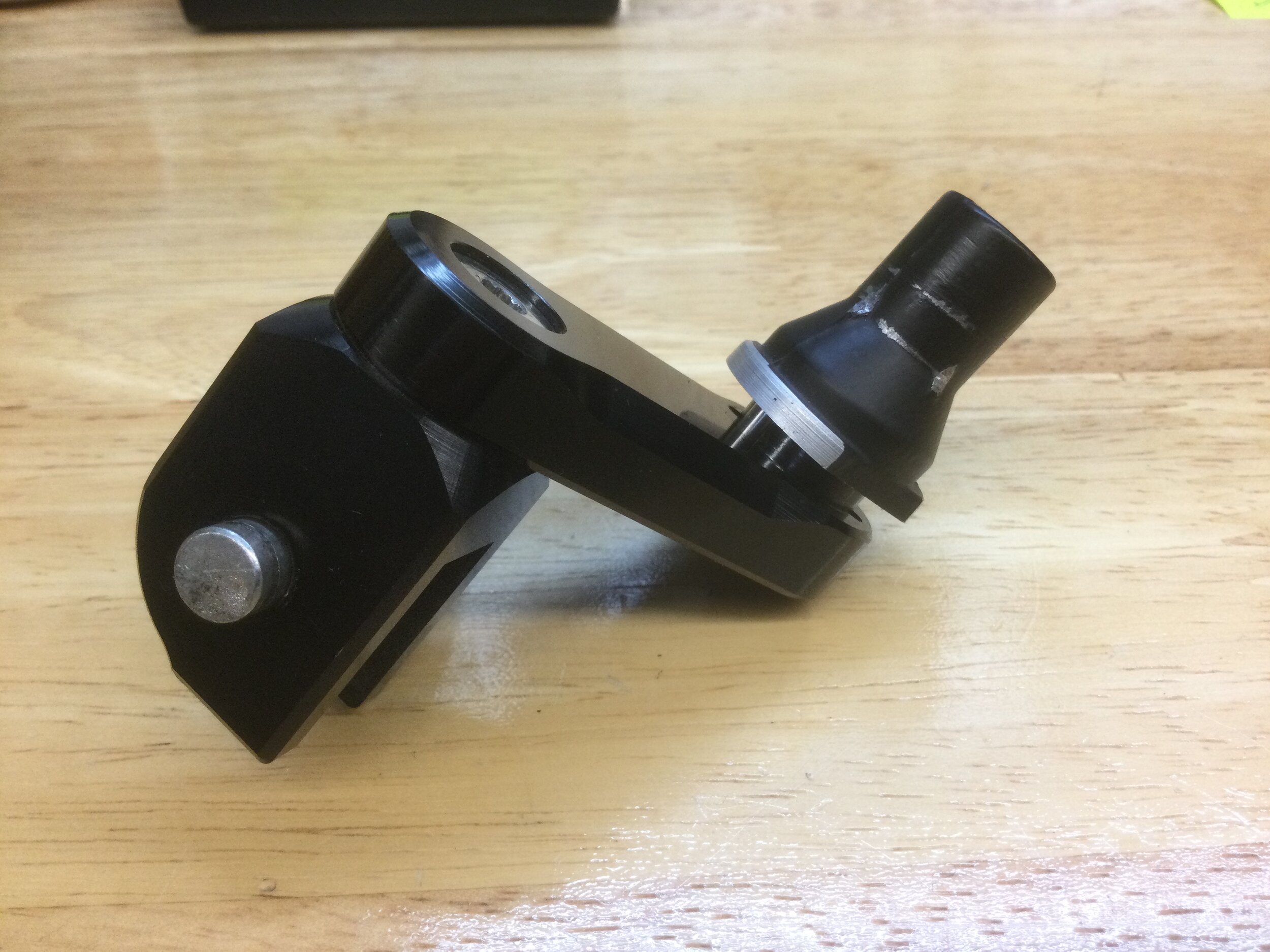

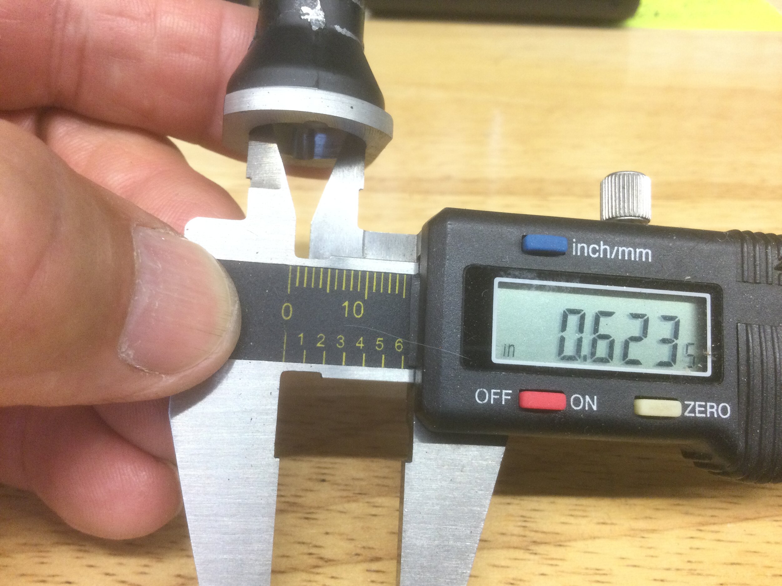

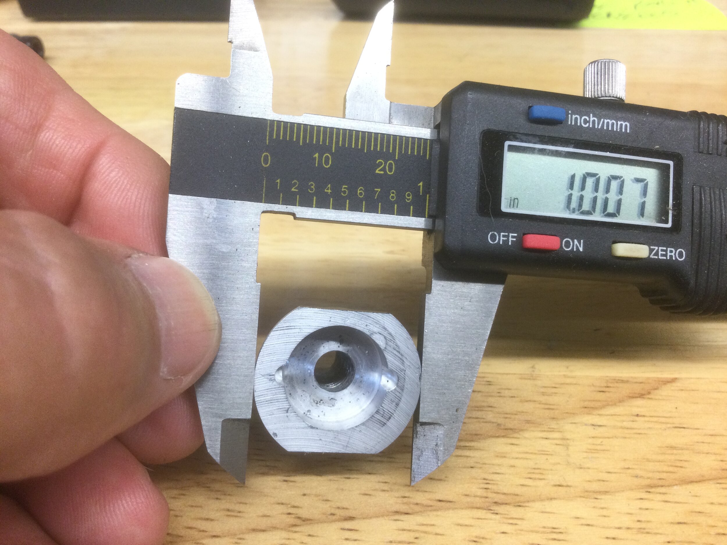

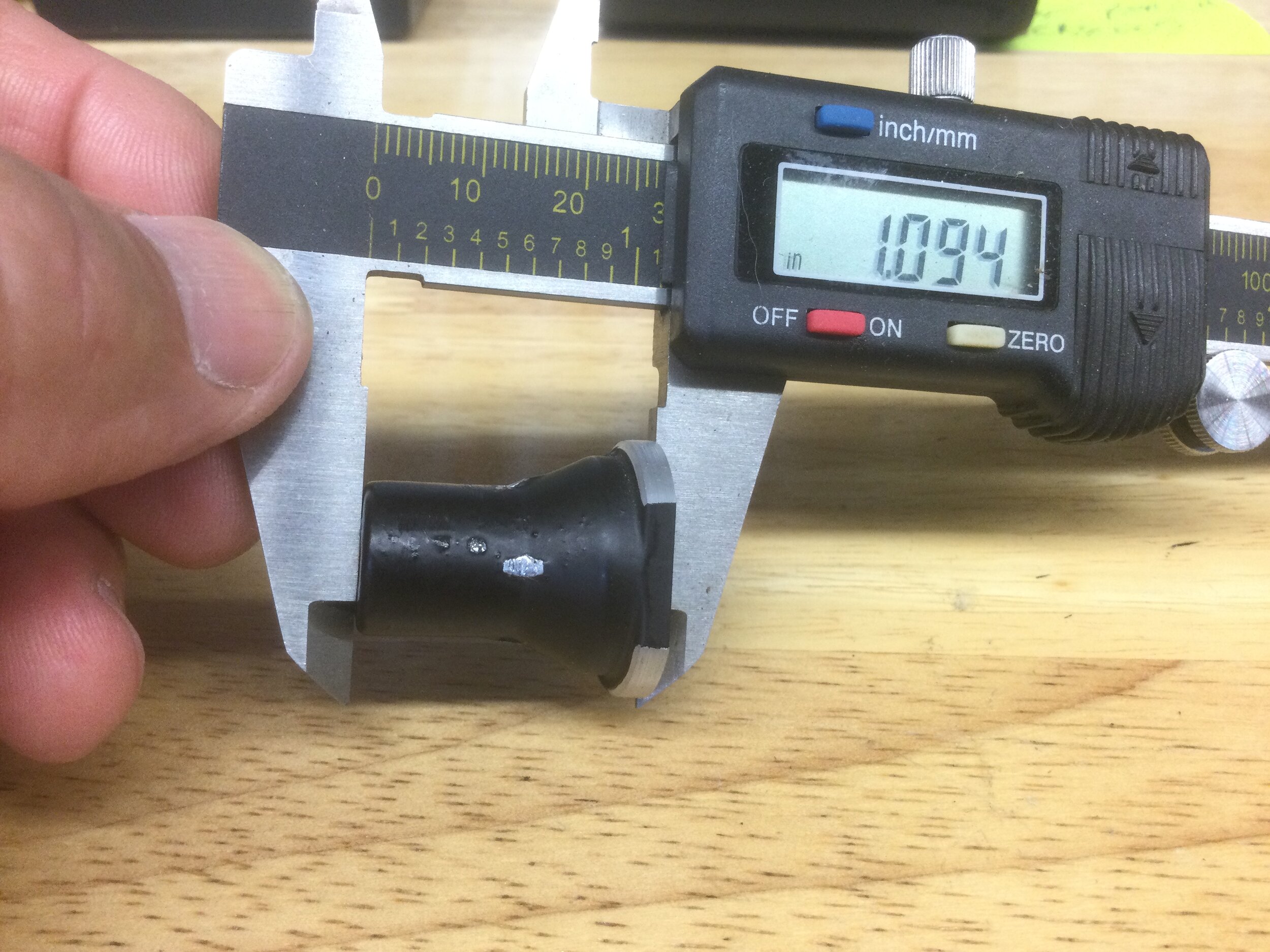

Hello again, mine have not spun, one end of the modified part is manufactured with a cone shape that presses in the peg and the other end is locked in with two 3mm pins. I’m sure you could spin the peg with enough effort but mine has not spun and I raise up off my seat on almost every ride but I do not stand up, I never have stood up on my street bikes. Even the factory setup is springy and I don’t trust them at my weight. I used blue loctite and I had to use quite a bit of force to remove the bolt today.
I’m posting several pics with measurements both in mm and inches, the only part that needs to be machined is the removable cone from the wide peg set, I used a 5/8” (.623) end mill for this with a depth of 5.10mm or .200” and a 3mm end mill at the same depth for the pins. You’ll need to purchase two 6mm 1.0 threads X 120 mm long Allen head bolts and two 3mm X 7mm pins.
I had to buy 10 bolts so if you like pm me your address and I’ll mail you 2 bolts and the pins for free.
I rolled my pegs 12-15 degrees forward for my comfort.
I’m glad to talk to you by phone if you need.

The pics didn’t post in the order I wanted but the last three pics are the cone as it looked before I cut it and after I cut it and machined it. Also the pics of the shiny black parts are from the drop peg set and I’m just showing them for reference. I hope I was able to help and good luck.
Thank you. This Saturday I will bring them back to work. I do work in a machine shop. Our tool maker will help me finish them to your specifications.

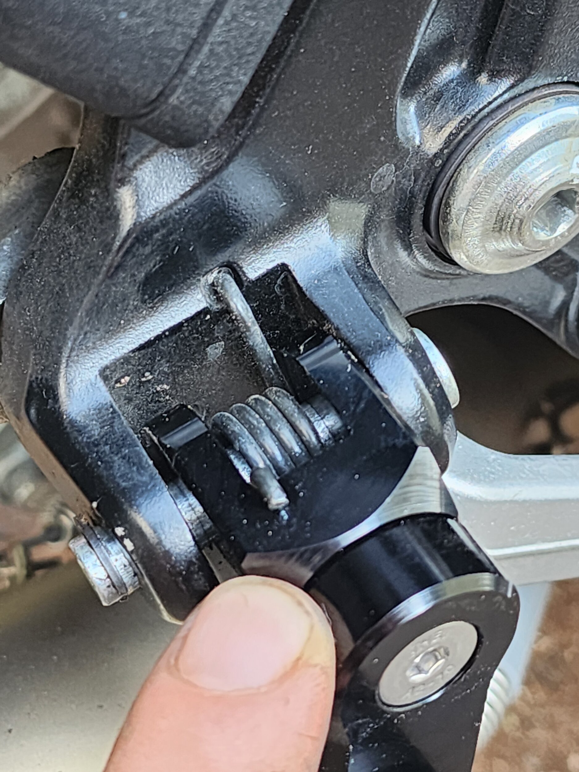

This one is because of how far they stick out? Feels uncomfortable. Is that what corrects that issue. I normally put my foot straight down and I can't. I see that's where you got the other part from. You cut off the part I'm pointing too?

Ok I understand now. You milled the part that came with the dually part. I though you cut it off the part that connects to the bike like I pointed too. I'm glad I did not mess that part up.
^ this statement is correct, the only part that needs to be machined is from the Dually. Glad you caught it in time.

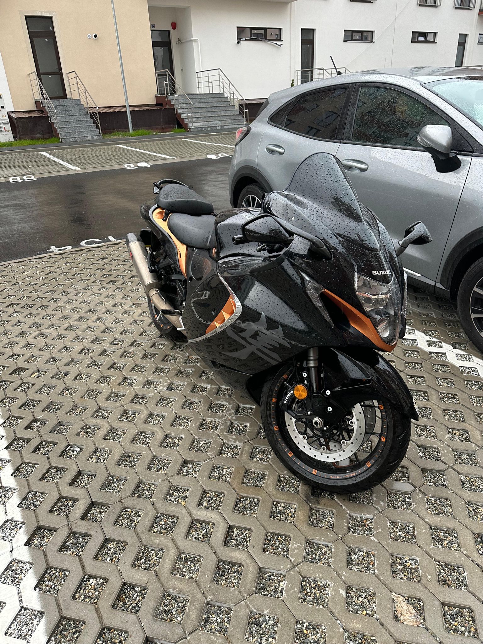

These are the mods I made on my 2022 orange/black gen3 :
- Yoshimura Onyx R77 dual exhausts
- DNA air filter
- Woolich ECU flash
- PAIR mod
- No O2 sensor
- Core Moto SS front lines with ABS
- Brembo Corsa Corta brake and clutch MC
- Skyrich lithium battery
- Schnitz quick turn
- Suzuki license plate bracket
- Suzuki passenger seat cover
- Yoshimura Wind Armor screen
- SP Connect phone holder
- Tecmate 12V supply
- Full black 2023 scheme
- Carbon heel guards
And next mod will be Woolich Q/S

View attachment 1668834Do you find a big difference with the woolich flash with the slip on setup
Armoni76
Jun 21, 2022
149
331
Nope, not really. The slip on only add a better look, sound and help to save weight. The woolich flash maybe improved the throttle response in the low and medium RPM, maybe :D
It's not like the gain was huge, and with this kind of engine full of torque, on the road only, not an easy task to feel small gaps like this.
