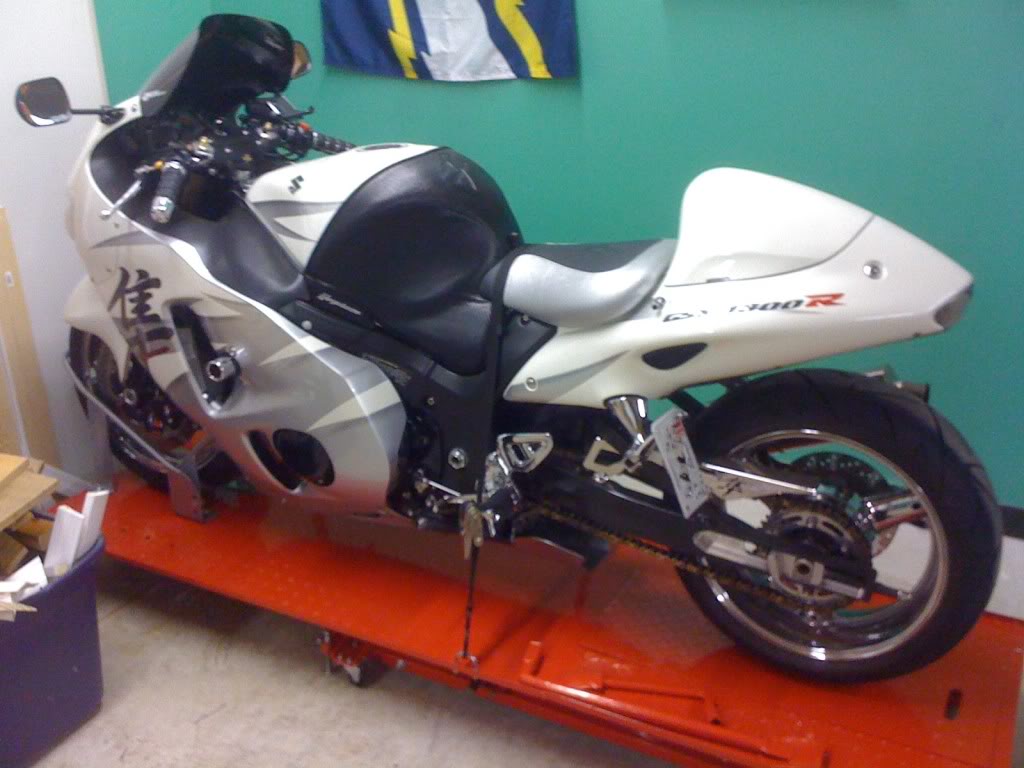

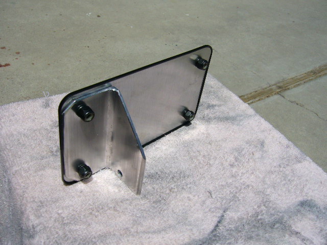

I've recently got a few inquiries about my lic. plate mount ((including Rashad) so here's the info.....
4" piece of aluminum channel stock
hack sawed it to basic shape
fitted to plate and bike for location of proper drilling holes
drilled holes
beveled all edges to smooth edges (grinder wheel)
hand sanded to remove big grooves
drill/wire wheel...still toward smoothness
final sanding
aluminum polish (Mothers)
mounted it and forgot about it!
all above sounds complex but it's really fast and easy AND people mention it all the time....it works great (and you can install the illuminated lic plate bolts if you really want to be legal.).

Nice job. How does it work with a pasenger?
What's a passenger?
(actually sometimes I give my daughter a ride and there is about 2" of space in front of the plate).

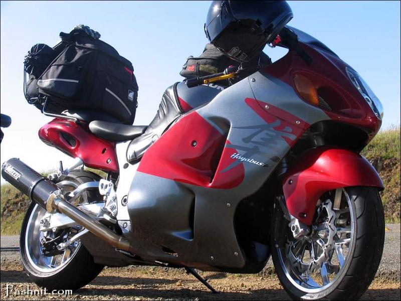

I just realized you were talking to me! The rear black rack (in one pic) then just a black crossover piece in the other pic are both part of the Ventura rack system......the third choice is the full tour rack with bags (not depicted)that ALL fit into the two black side mounts, I love the system, works for all uses except the track! Doyle

Here's a couple of addl pics to further illustrate the Ventura System....the red bag rack is called the "sport rack" (I didn't like the red bag so went to black) and the other pic is the "tour rack and luggage" when I went on a PASHNIT tour. It has amazing capacity and doesn't tough ANY painted surfaces. Doyle
ps if you ride double, you just reverse the rack so the luggage mounts behind the passenger.
