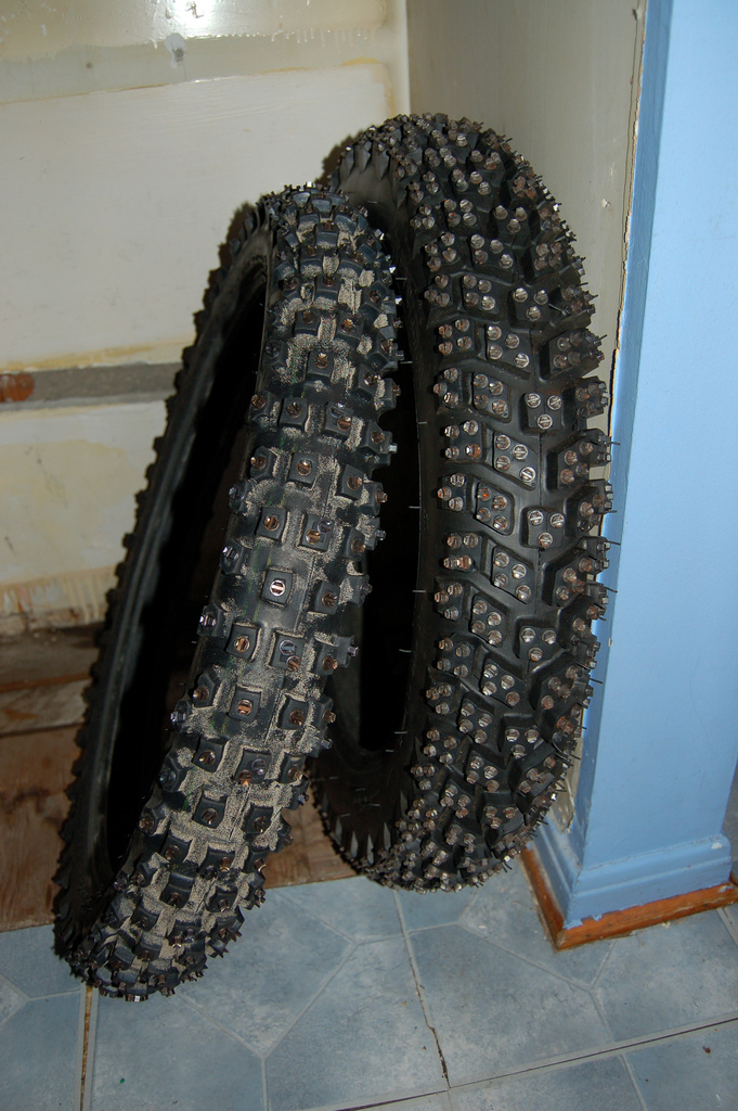

No issues with lowering the front .75" and leaving the rear at stock height? I'm thinking about doing it to mine since I spaced the controls up a bit.
I know for ice racing we lower our entire bikes by running the preload back up on the shock, and lowering the forks a couple inches in the triple trees, but that's for left turn only, sliding around type action. Nothing like street riding at all.
I did it two winters in the 80's. We used to put screws in our nobbys.
