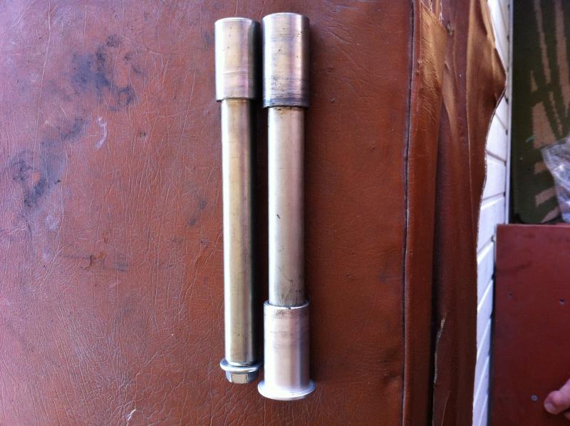

I got the gen 2 front on but i have a problem with the front wheel. i used the gen 2 axle with my gen 1 wheel but the wheel slides side to side a considerable amount like im missing a spacer or something. Does anybody know whats going on?
gen 2 axle on left!!
Gen one axel won't fit! The sleeve the axle screws into is too big a diameter to fit in the fork.
Thats right i forgot, you need the spacers that a guy on SH.org makes!
