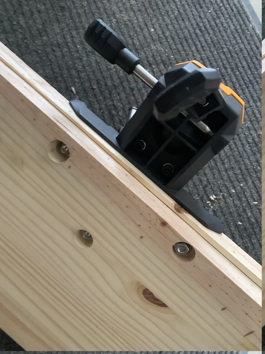

We do not have a vise yet at this house and so this has been on the obvious list. It is on the bike list to replace the cam set in the clutch with the Brock's hub, requiring torquing of the 6 bolts. That need resulted in working out a vise setup at this time.
I purchased the Work IQ vise and a 48" pine stair. I cut the stair in half, stacked it, and purchased shorter bolts for this configuration. I investigated how to make a pocket hole and purchased a 3/4" Forstner bit. I had problems one, with standard bits walking on the wood and two, the circular saw walking. I had thought to get a brad tip bit but figured it should not be a problem for this. Brad tips are now on the wish list now as I have always hated standard bits for wood. Regarding the circular saw, I cannot cut straight with it. Even butting it against a straightedge, while it cannot go that direction, it manages to move away from it. There is no room for a table saw so long-term I am unsure what to do other than being disappointed with every project that requires cutting.
I will clamp this to my work table when I need it, and put it aside when I want to see a nice broad tabletop with no interference.
Maybe you've tried but if you need a hole drilled that precisely and you can't use a drill press, start with the smallest bit you have, drill a pilot hole and work up to the diameter bit you need to use. With wood, you could go very incrementally. Metal, the bit probably would bind if it were just a bit larger than the pilot hole.
As for the circle saw wandering, that shouldn't happen if you clamp down a straightedge. I think you'll get it with a little practice. In the meantime, plane a/o sand the extra material off. It's time consuming but if you need it fairly precise, work with what you have. DIY projects always take ten times longer for me because I usually don't know what I'm doing. It's quicker the next time. ....just don't go too quick when you think you know it because that's when you're going to screw up. :D ...at least I do. "Always the years. Always the love. Always the hours." I don't know if that's from the book or just the movie but that quote always comes to me when I realized I just spent a whole day working on something I love. I weighed my 14R on bathroom scales tonight. It took a few hours. ...just to weigh the front and back of a bike. Fuel tank full to the neck, 600.16 lbs.
Yes I did. The pilot bit must have slipped. I should have fitted the vise early on, after the pilot holes, as a check.
I found a nice guide system for circular saws at the big box store. It is $99. That is probably a good move.
