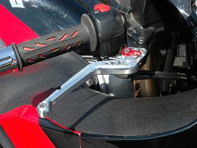

been thinkin about gettin some new levers, what's the best one's u guys are runnin, Pazzo's?? Is it difficult to remove the stockers and install the new one's?

pazzos for me, and its one of the easiest mods you can do :thumbsup:

Install is very easy. You will be surprised at how easy it was once you start into the project. I would guess less than 10 minutes per side on the first attempt.

You asked about FP Tactical levers. That's what I got. Highest quality. Awesome company. The thing that sold me is if you drop the bike, these levers will 'flex' so they don't break. They've got any color you could want, and logo is available. Short, or long levers. Purchased from Tim at pashnit.com (sponsor). As for the installation, remove one bolt on the brake side, slip old lever off, slip new lever in, tighten bolt. Clutch side: remove one bolt; remove old lever, slide the bushing out of the old lever, slide it into the new lever and align to actuator arm, install new lever, replace bolt. It's that simple. As for feel, the FP's adjust in--and out--further than the stock. FP's have 6 positions, so you can pretty much tailor the lever position/travel to your preference. Color, adjustability, engraving, etc., are all similar to Pazzos. The difference and what decided me was the ability of the FP Tactical's to 'fold' on impact, then return to shape after. Whatever you choose, Pazzo, FP Tactical, etc., this is a good mod for making you all that more comfortable as you ride. Highly recommend. BTW, I have Heli bars and a 3/4" Genmar riser on my bike, and the FP's clear the fairing as well as the stockers, i.e., no interference. Alan
Caveat: On the FP, the '1' (closest) setting on the clutch side did not actuate the clutch switch when the clutch lever was pulled all the way in. The bike would not start with the switch not actuated. I used '2' and then '3' anyway. This is not a problem peculiar to FP. I've heard of it with others manufacturers, too. The fine dimensions on aftermarket parts are often just a little different than those of stock components. It wasn't a functional issue but actually, it bugged me enough I put a drop of JB Weld on the end of the switch shaft, let it dry. filed it lightly, and subsequent to that I could start the bike with the clutch in '1'. But unless you need that final 1/8" '1' provides over '2', then this is not an issue at all, i.e., '2' brings the clutch lever in toward the grip closer than the stock lever adjustment ever did.
