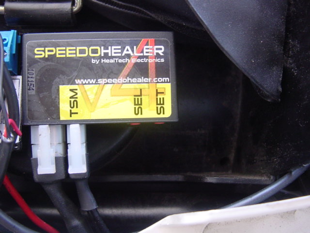

Get a speedohealer. It will then be right on!!

I put the speedohealer on mine, -7.5% put it dead on. Now I've installed the 43t rear sprocket, it's set at -15%

speedo healer is the way to go. 42T dialed in a -9.7%

The faster you go the more it will be off. You can get it accurate @ 60mph with the Speedohealer or Yellow box but it won't be on at 160mph. It can be anywhere from 6-16% off past 150mph+...
