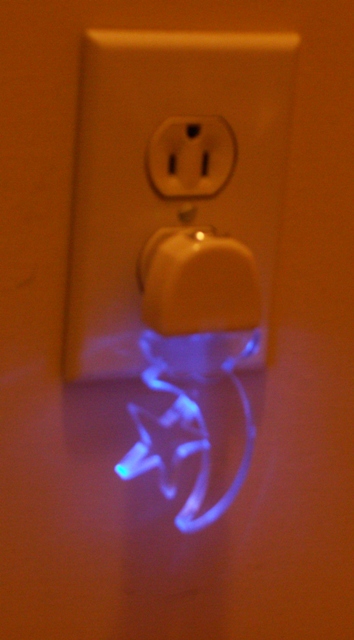

What I can't seem to figure out is why in tarnations do some electricians install plug outlets upside down? i.e.. the ground plug on top. Bothers me to no end as the nightlights, plug-in air fresheners..etc are not designed for this. Thought the builder was being hateful towards us till I seen several other houses the same way? What gives?
No this photo is not upside down..lol
I've been slowly going through the homestead flipping them around.

probably installed by an electrician that worked mainly commertial buildings ( some places its code to put them that way)the thought is IF they are installed with the grounding ( D hole) down and something was plugged into the outlet and wasnt plugged in tight, and then a metal object fell on top of the cord plugged in and touched the Hot and grounded conductor it could/ would cause and issue.. ( Like at Hospitals ) you wouldnt want to trip a breaker due to a duhhuh . So they go to extremes to make it safe. Usually residentials are placed grounding hole down..
