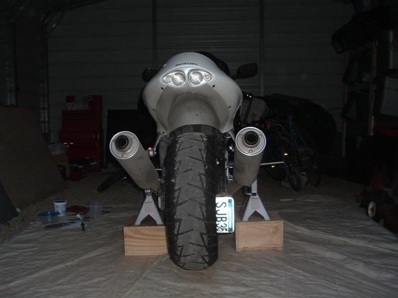

bike up on my home built...dirt cheap stands cost me only 12 bucks for the jack stands at walmart...can to the same for the front when it time to store

full access to the pipes woohoo

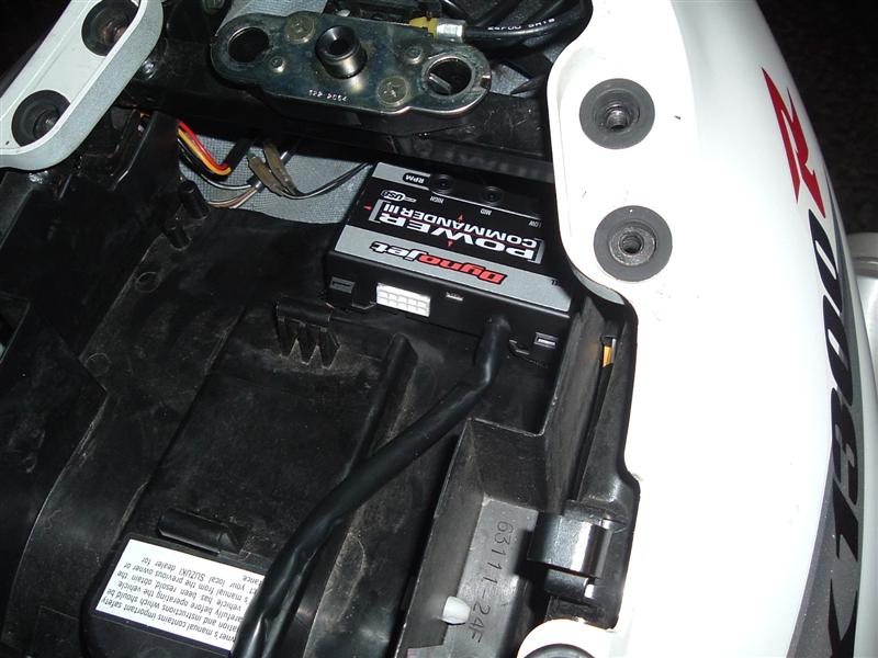

wires on left side of bike that ya hoook up the powder demander two..

Might want to put cardboard or something over the radiator so you don't bend the fins.

placement of the power commander in the trunk...what you going to do with all that junk.... all that junk ...up in your trunk...oopps sorry kids playing music agian

cardboard will be added tomorrow..for sure...

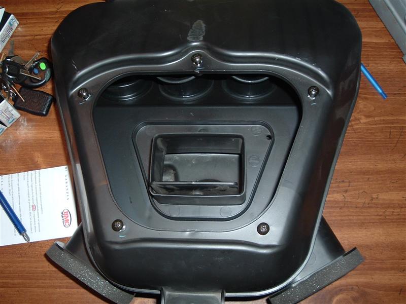

ok here is the real airbox....

i drilled with my dremmel holes all the way around the inside of the flange..then i heated up a knife and slid through the spaces...then used the dremmel again to sand the edges and then the knife again to scrape any dingles or sharp edges...

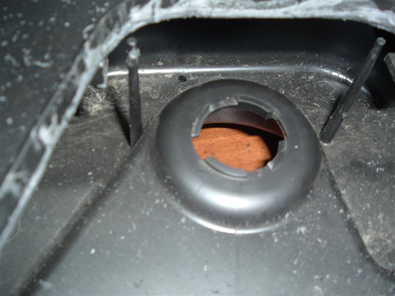

shot of the actuator valve thingy..will be working sealing it off at work tomorrow...yea i know...goverment jobs lol

ok...now if i remove the valve and seal the bottom.....does that effect anything electricly
Don Hardcastle
Busa Ridin' Sailor (ret)
Jun 25, 2004
4,055
87
(chrisjp @ Sep. 30 2006,04:08) ok...now if i remove the valve and seal the bottom.....does that effect anything electricly
No just make sure you plug the vacuum line that goes to the valve.
