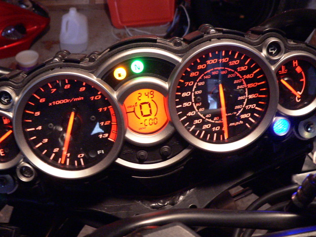

I turned the key on. Still had the C-00 code on the display. Just means there is NO FAULT with the engine not running. I started the motor and the C-00 was still there. That means NO FAULT with the motor running!!! NO code!! I pulled the jumper wire out of the diagnostic plug and lo and behold---I have my odo back, NO FI warnings flashing. It's fixed.
Engine running after error fixed, diagnostic plug jumped,
Engine running after error fixed, diagnostic plug jumper removed
