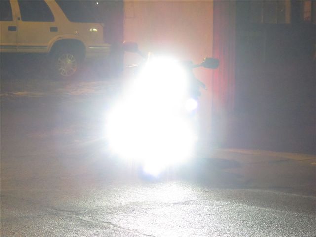

So it got up into the 50's here today, so I left work a little early, rushed home, and threw on just enough plastic to make the Busa legal. I took a few pics before it got dark to show what the Clearwater LED's looked like in daylight. Keep in mind I replaced the factory headlights with a 55W HID kit (6000K low / 4300K high). The Clearwaters color are almost a perfect match. Once it got dark (and cold), I was able to get a few videos (sorry about the windnoise). Originally, I planned on getting some shots of just the LED's, but it I forgot...maybe once it gets warmer. So the videos are of all 4 lights on, with the occasional dimming of the highs for oncoming traffic. Don't know if it shows, but the combination is UNBELIEVABLY BRIGHT. So far, I'm loving the Clearwaters, for the added light, but mostly for the appearance it gives oncoming traffic. If I had to do it over again, I definetely would purchase them.

Looks awesome, bro. Your bike looks like a UFO. Man, those lights are bright.:bowdown::bowdown::bowdown:

I was pretty impressed with the quality and effectiveness of these lights, properly aligned they are not offensive. They should be adjusted so the peak of the beam source is under the peak of the head light to work more like an effective fog light than an additional headlight source. Cool part is the light's beam will round the corner as your eyes do at slow speeds, since they move with the front wheel. :thumbsup:

I aligned mine perfectly level like the instructions said, but I may slightly angle them down.
And as you mentioned, the turning lights really grab your attention at slow speeds...great for going around corners. Reminds me of that Tucker car.
