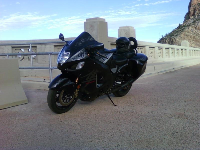

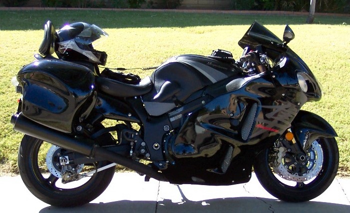

BTW...beautiful bike.
Hahn racecraft wouldn't been my choice for turbo systems (even though I have owned a few of their kits)
But the dual exhaust is a dream of mine and the bags make the perfect sleeper.
BUT....we must step into the real world with the modern liter bikes and realize that a 550 lb bike with 230 rwhp and bags...might hold its own,but won't show them up the way it would had in 02.
love the bike man :thumbsup:
who fabbed the exhaust?

and absolutely love seeing the OEM mudflap is in place.
:thumbsup::thumbsup::thumbsup::thumbsup::thumbsup:
put some oem but modded stickers on it :bowdown::bowdown:

Very nice bike....... looks like a good "touring" bike....
and you picked the fastest colour...:thumbsup:
