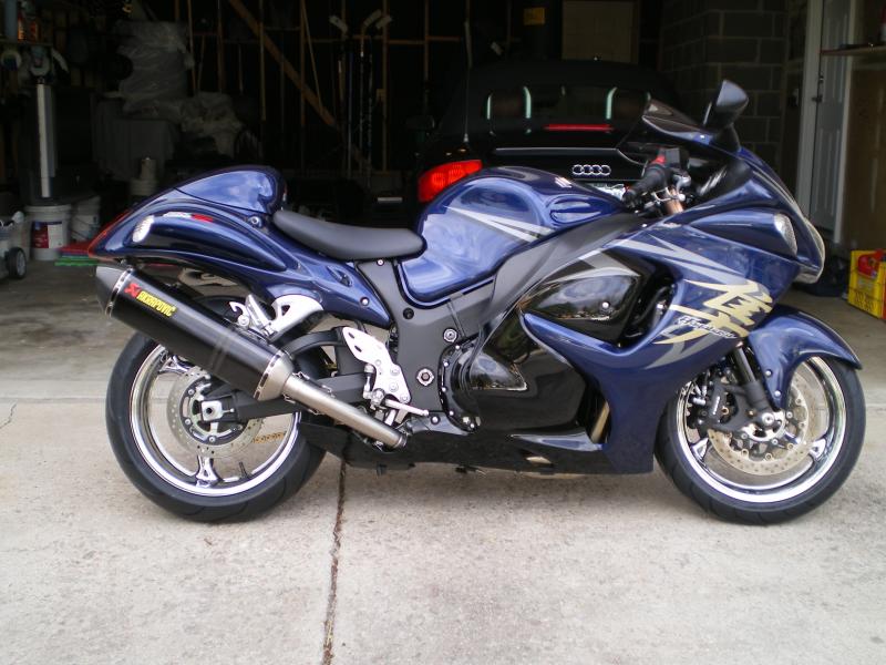

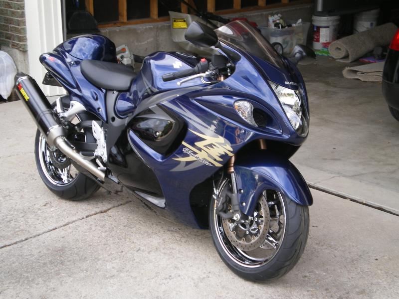

Enjoy the install, be patient with that Akra system, getting those stock headers off, akra's on is tedious. make sure to unbolt those oil/water cooler bolts to loosen the system without discounnecting any hoses. I'm super slow doing this, followed Blanca Busa's fairing vids to take those off. Total time was about 5 - 6 hours for me. Again, I'm super slow. Emma is a picture ***** and wants to be see so here you go.
Oh Yeah!:thumbsup: looks great! I've been saving for that exact system for a while now, and I'm almost there!

Congrats on saving to pay cash for the system! :beerchug: Oh I suppose she'll let me post some more pics.... :rofl: Speaking of Akra's, when you get them, first thing to do before install, pull out those baffles (silencers on each can), they really restrict airflow/sound. After 500mi she's getting much louder, would imagine around 2k miles from install she'll be roaring. You'll love the sound!
