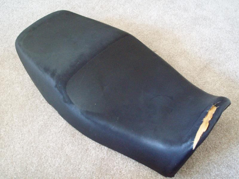

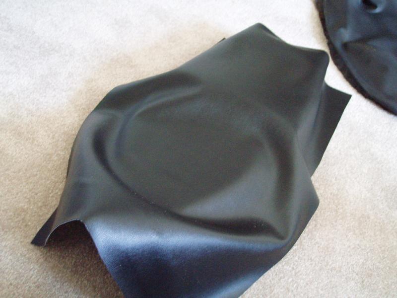

So here I am posting it in the right section today! I was able to get the seat cover material in today, and started replacing it! Thanks Jason for posting up the place to get the seat covering material. (diyupholsterysupply.com) I got the all-sport black Vinyl. Total to my door was $32. Not bad... since I have enough left for covering 2 more seats. So here are some pictures of the start to finish. Not bad for my first time, and I learned a lot from it. The new covering made the seat feel so much better. The old one was hard and didnt provide any cushioning! I took a 30 minute ride today and man it is so much better then the old one!

Here is the finished product on the bike. It would of looked better if the foam wasnt brittle in a few spots. It showed really bad at first when I covered it. I did lay another piece of vinyl under the seat cover to hide the holey foam. It helped a little, but next time I will get a very thin piece of foam to cover that area and recover it. But for now it is much better then it was!
