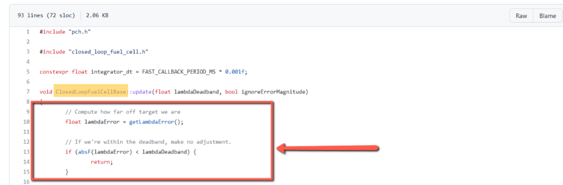

I’m not sure where you heard it only makes small changes. I could be wrong but my understanding of the factory narrowband is the closed loop compensation only happens when out of range of what the narrowband reads. So if richer it will try to reduce fuel, if leaner it will increase fuel.
Kinda like the AFR target is all the narrowband can read (14.6:1 - 14.8:1) and all the ecu cares is if the measured reading is above or below that.
They state this more eloquently than I can:
I’d love to dig through Suzukis code. The open source ecu I found there is a method that calculates how far off the AFR is and shows if it's within range to not make adjustments. It would seem reasonable Suzuki would do something similar.

Read my post again. The sensor makes no changes.
Just because the sensor only reads 14.6-14.8:1 doesn’t mean the engine will only adjust within that range.

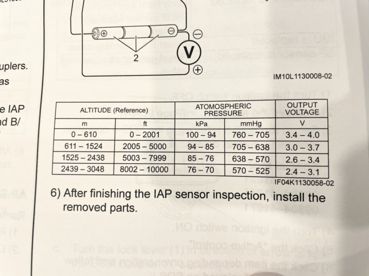

The atmospheric pressure sensor (that I’ve removed from my bike) reads from 0 - 10,000 ft which means the bike can be run in a wide range of conditions. For that to be possible I’d imagine it will need to make big changes.

You stated the stock O2 sensor doesn’t make big changes. That’s not accurate. Sensors are inputs- they don’t make changes.
I posted the code from an ecu that’s responsible for reading the O2 sensor and calculating the right amount of fuel in order to achieve the target AFR. The ecu determines the change, not the O2 sensor.
I mentioned the barometric pressure sensor to illustrate that the ecu can and will make big changes. And Greg mentioned how it’s relevant to the OP’s question.
