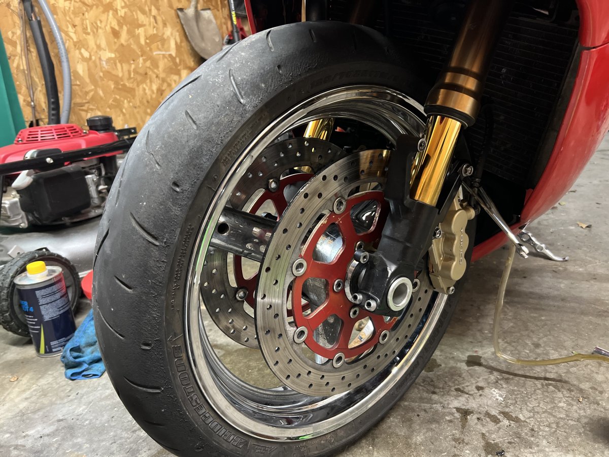

Slowly but surely we are getting there!
nintastio
May 3, 2022
395
715
New rotors on the front, and I have the parts to remove the stretch minus the brace for the rear caliper but it will be here tomorrow. Once the stretch is removed I need a new set of tires and it will be to the point I will probably leave the rest alone until the riding season is over.
