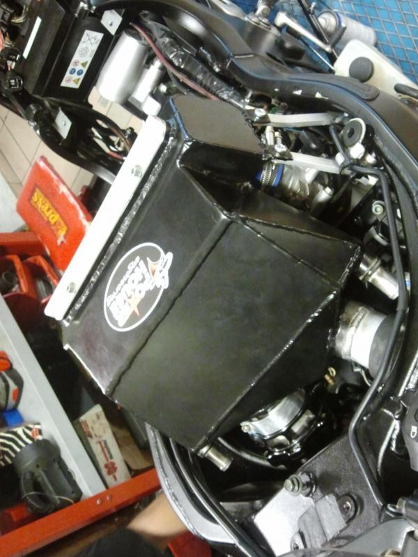

I have spend the last 3 years reading (i literally have read the whole Hayabusa site and more) saving money and buying the best available parts since repairs are not an option where i live (Greece), i had to succeed with the first attempt.
First i bought a MCXpress race kit with water intercooler and secondary injectors (used of course) from a German dragster member then a Bigcc scavenge pump along with a Mocal water-oil cooler, a Bigcc scavenge pump which i didn't used in the end (sold), some gears, pumps etc and finally saved enough money for the build and tuning from a specialist.
I am very happy now because believe it or not the whole project cost me 7000 Euros (about 9100$) when my yearly income is 13 to 16 thousand Euros, i even had to stop eating properly...
BTW my gen1 2007 model Hayabusa makes 270 hp easy, safely and with a full exhaust.
The only thing that bothers me is that it makes 270hp with 11.5psi boost, something that i consider a bit high.
Here are some photos...
Chris

You have what appears to to a water-to-air intercooled plenum, but it is not connected - there is no heat exchanger on that bike. Is there a reason you did not take advantage of the tremendous benefits this would reap? You would be doing the bike big favor by taking this next step . . .:laugh:
No it is fully connected, the photos were taken early when everything was tested for good fitting.
It has a very good electric pump like the aftermarket ones for the main water cooling, a water cooler made from a cut spare hayabusa water cooler and an overflow tank.
