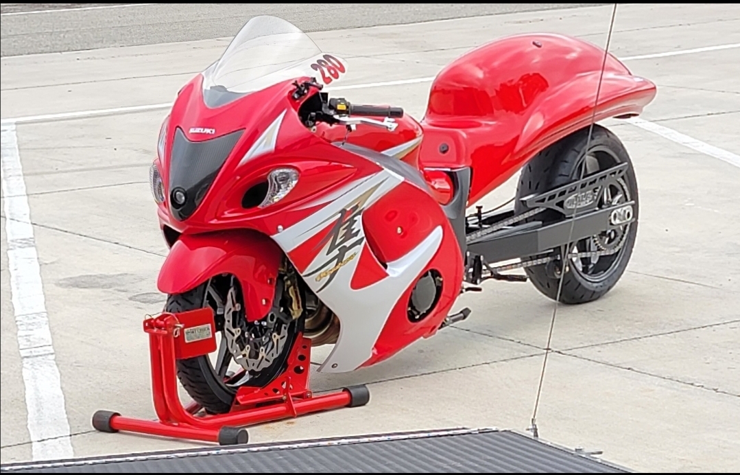

8.20 at 164 NA? That's hard to believe. My bike weighs 445 lbs and it's 625 race ready. I've been 1.261 to the 60 ft and 8.51 @ 154. Going to make some more hits tonight and it should break into the 40s. The engine is completely stock, valve covers never been off and the last time the plugs were installed the bike was in Japan.

It won't make any more MPH @ 625 lbs with the current 17/52 gearing. I need every bit of mechanical advantage possible to try to get into the 40s. I've been 158 at 17/47 but it's a 10th slower with that gearing. I just want to go forties once, then try to spray the stock motor into the 7's or blow it up before I put in the big motor that's sitting on the stand ready to go. Loading it up now and heading to Orlando Speed World
What clutch set up are you running? It will go 7s with the spray for sure.
