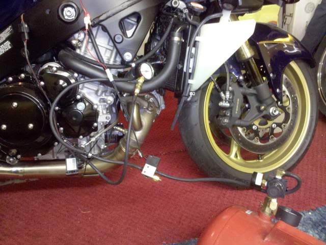

Got a chance to do some testing this evening with petriks ECU boost control :)
I had a choice to either drag the bike out to the barn where my tools and air compressor are, or rig up an air tank with a regulator on it to be the supply source. I basically have an air supply feeding a 1/8 npt air solenoid that is controlled by your software petrik, then on the output of the solenoid i am feeding the top side of the wastegate, gm 3 bar map sensor, and a mechanical boost gauge for me to watch. Engine is off, and just monitoring boost pressure on the top of the gate. I have a small air leak somewhere, but a leak of some sort is needed so that the wastegate can relieve itself, i think with the adjustable exhaust leak i have on the solenoid you can tune how quickly the boost bleeds back off when you downshift to a lower gear, making it leak off quicker will make the solenoid have to run more continous to maintain pressure.
Anyhow here are 2 videos, 1st with lower pressure, 2nd with higher pressures, there is some overshoot, but its hard to say how actual behavior on the road would be as I would be just using the manifold for air source vs 30 psi coming from an air tank, it would have longer to build up and probably overshoot less.
Anyhow, man for a first crack this seems to work pretty darn good!

got a 30 minute ride in before it poured, never got a chance on the nice flat smooth road to get a sweet datalog, but this is close enough, you will see i never get above 80% throttle, in 1st gear i am only 40-50% throttle,
gate springis 6 psi, 1st gear only 4-5 psi with so light in the throttle, but the rest of the gears working out quite nicely :) I am sure had i kept in it 100% throttle boost traces would have been much nicer, but man a stock arm is a trip LOL.
1: 4.5 psi
2: 6.0 psi
3: 8.5 psi
4: 10.0 psi
5: 13.0 psi
6: 14.0 psi
