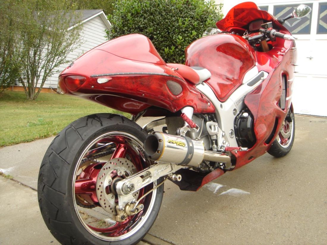

That's an odd undertail. Is it just the image compression or does it really look that jagged?

I took my inner fender off.
After cutting and sanding you can take a heat gun and 'smooth' out any roughness.
I made my own bracket for my shorten factory turn signals.
Best picture was taken before a winter ride. +1 for Gerbings heated gear.

Winter ride?? Of man that must be cold..... Undertail looks good. I think im cutting mine this weekend... What did you do to shorten your lights?

To shorten the stems.
I took them apart and kept the 'screw' end on. Cut about an inch of rubber off then shaped the rest with a dremal and knife to the same shape as what came out of the turn signal.
I rode this morning to work this morning so my bike was outside (frost on the ground). I snapped these pics of the bracket I made and of one signal.
