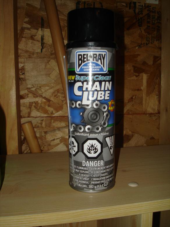

Hey everybody. I would first like to thank the forum for all the knowledge that it has given me, but I always like to double check
What I was up to was cleaning my chain and relubing it before I put it away for storage.
What I did was:
1. Use a rag soaked in WD-40, cleaned the chain with the rag and a brush.
2. Let it dry, then went for a quick rip to heat up the chain.
3. Sprayed the lube on the sprocket side of the chain while rotating the tire.
4. Let the lube set in to have wax settle in.
I used a product called "BEL RAY" chain lube. I did what the instructions said, but i was just checking if I missed anything. These pics are what my chain look like after the job. Did I do everything properly?? Is there another product I should use?? This is the product they use at the bike shop.

Do exactly what you did every time for the entire time you own a chain driven bike for the rest of your life and don't listen to any advice otherwise.

Now do it frequently and your set

I HATE that stuff. It slings everywhere. I threw half a can away cuz I was so pissed at the stuff. Only use maxima chain wax now.

Looks good...
My stock chain was waxed and it threw gunk all over the place. I haven't had an issue since I scrubbed it off and started using regular lube.
