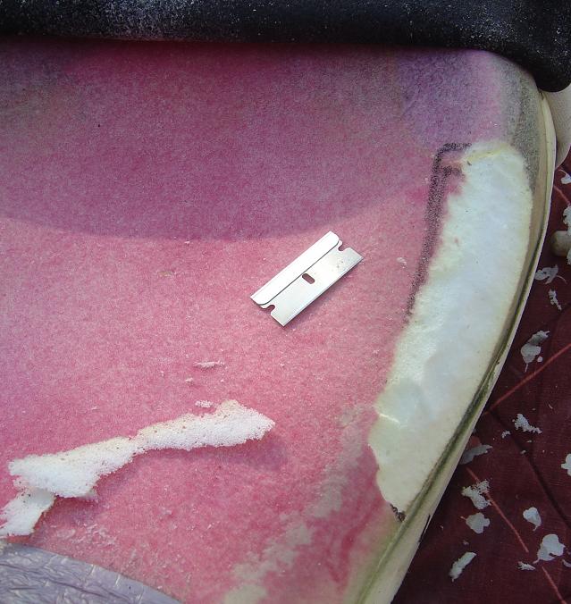

I love my Corbin seat.
The foam is firm yet does not hurt my skinny butt.
But there seemed to be a ridge along the edge of each side (in red) that started to cut off the circulation to my legs after a long ride.
It needed a bit of adjusting, so I drilled put the rivets holding the cover on, peeled it back, sliced off some foam and then smoothed it out with a belt sander and fine paper (be careful it eats foam if you are not), replaced the cover and added new pop rivets and ....fixed.
I didn't take off much but it was enough to stop the problem.
Much more comfy now.

Very creative! What size rivets did you use when you put the cover back on?
I have a big box of mixed sizes, and just picked the ones that fit into the existing holes.
It is easy to drill new holes to fit whatever rivets you have too.
I used a 1/8 inch drill bit to drill them out, and it didn't make the holes in the seat any bigger, so I would guess that is the size.
They needed a fairly large head (or washer) to stop the material from ripping, and were only about 1/2 inch long.

That is exactly my symptoms, and my mod does fix it, for me and I think it would for you too.
I have the Buell pegs too, and now I can use them with the seat, and no sore thighs.
