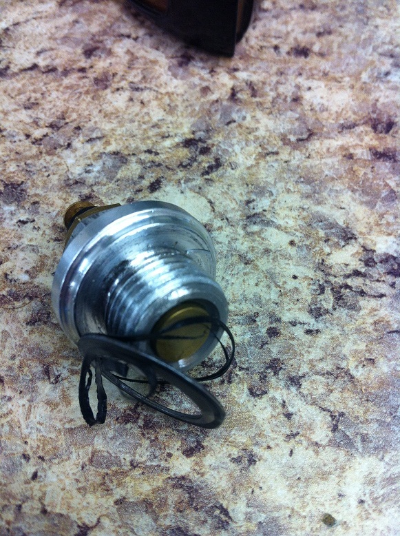

Used motor I just got. Is the sensor not tight enough? I just pulled the sensor and found the following. That crush washer/gasket looks small. Is that right? I don't want to over torque...

Just replace it with a copper crush washer!

I have a copper crush washer but it is thicker than the one that was in there. I'm worried that the sensor won't be threaded all the way in with the thicker washer and it might back out while in use. I'll give it a try. I just over nighted a replacement washer, too.
The motor is in a sand car.

The thicker washer will be fine!
The sensor you have there is not a Suzuki oem sensor! It probably has a lower temp, than an oem!

That's what I was thinking, doesn't look oem. I'd buy the OEM one and wire it up correctly. (one wire coming off that thing? oem has 3 if I remember correctly)
Stupendous
Dec 26, 2011
