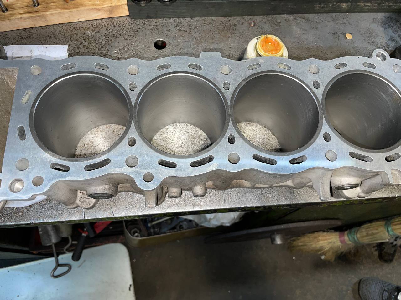

Why are u sleeving the block
Because the cylinder has some distorsion (if i translate correct), so i decided to sleeve cylinders but with stock bore. And thank you for answer about gasket! Now remains the question the thickness of the gasket.

Hi guys, need your help. I have a 2006 busa and do an engine rebuild. I am sleeving my block (bore is still stock - 81mm) and cut a 0.01 mm (0.0004 inch?) from top of the block. And now i need to choose a head gasket (thicker). So i have some questions. In USA tuning companies i found a gaskets with different thiknes - 0.018, 0.030. What thikness would you recomended? And i still dont understand, what thikness of stock head gasket? And another question, in shops the year is indicated like 99-2023, sometimes - 99-2016. It means that head gasket is similar at all of generations? I will be very grateful for the answer!
There is not enough room to sleeve the block, and why would you?

They sell sleeved blocks ready to go, both for dry block and water cooled applications so it’s doable.
Would probably be cheaper to get a used one and prep it, bcuz depending on how messed up his is, a hone and replate might force him to go bigger bore.

Because the cylinder has some distorsion. You think the distance between cylinders too small for sleeving? But some busa owners do this and bikes are riding. I can attached photos of my block
