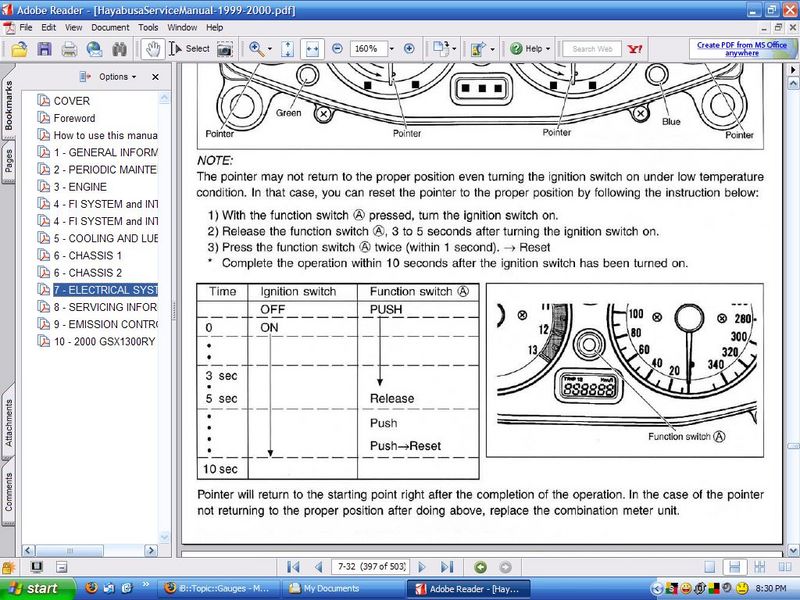

You can try reseting the cluster.

Gotta love HIDs. Do the reset above and if all else fails disconnect the battery for 10 seconds.
