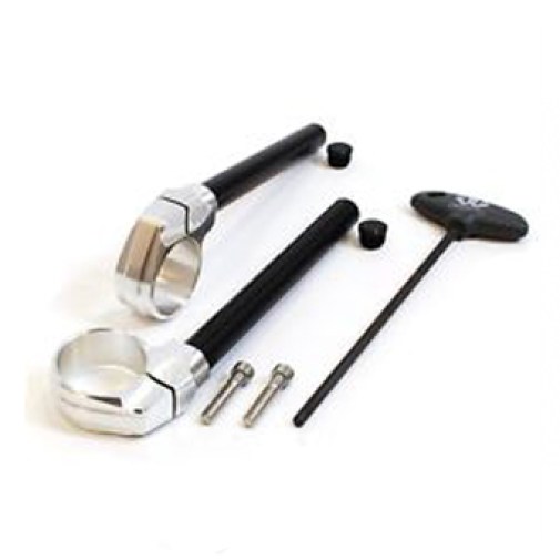

You can remove the top plate and put clip-on's on
1 lbs wow= ca 246 gram per piece and angle 6degr
https://tstindustries.com/Gilles-Tooling-50mm-GP-LIGHT-Clip-Ons-for-Many-Sportbikes.html
