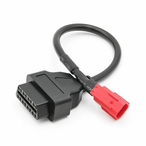

I got the euro 5 adapter on Amazon and tonight I successfully connected my Wi-Fi OBD2 cord I use on my vehicles with the OBD Fusion app on my phone.
$28 Wi-Fi cord
$15 euro5 adapter cord
$10 app
