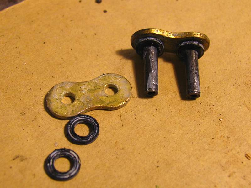

This comes with the new chain
So I attempted to put my new chain on, and I'm pretty sure I did something wrong. As you can see in the picture it looks nothing like what my old chain looked like or what your pictures show. Not really sure what I did wrong, but I guess I will buy some new rivets and try again.
Did you flare the rivots?
They will be between
.210" -.230" average, depending on the brand, but should be roughly the same size as the rest of the pins.
See post#2 above

Did you have the flat link completely seated aginst the link, with the 2 pins sticking through?
If not, that is your problem.
If you did, then you didn't flare the pins enough.

I had a really hard time getting it to seat, so I am sure that is where I went wrong. So now I have to source two new rivets.
